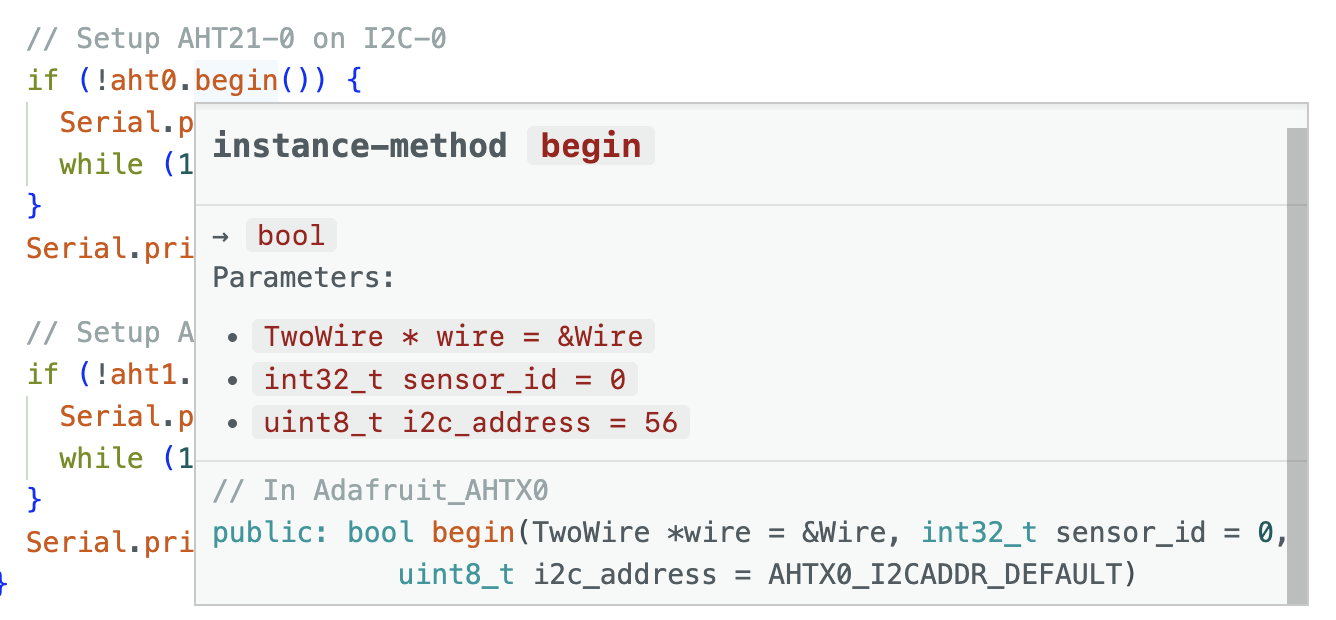

Here are some clues. I don't know what sensor\_id is, and I assume you will also need 2 wires?, but the 3rd argument to aht1.begin must surely be AHTX0\_I2CADDR\_ALTERNATE
 ![Screenshot 2024-12-05 at 15.42.38](https://europe1.discourse-cdn.com/arduino/original/4X/5/2/9/5296e50f889951c2107297e94a8db0e975c89f6a.png)
 ![Screenshot 2024-12-05 at 15.43.00](https://europe1.discourse-cdn.com/arduino/original/4X/b/0/d/b0dd65eb7f910d5f4a7a6d71fc0f64eaf0500e38.png)

Ahhhh, this is super helpful @sonofcy. In the 1st post the **I2C\_Scan** example shows the address of both, which is the same (0x38). I actually didn't know the tool-tips could be that useful. I didn't know the arguments, so this opens up a whole world of exploration. This is exactly the type of tip I needed. I'll chase this down & update for posterity.
Thank you so much! Prompt replies mean **EVERYTHING.** Can't thank you enough!

I didn't mention that the second screen grab is a 'goto definition' on the .h file. It adds it to the IDE and you can look at the contents (write protected) which was the clue that two can be handled. Then the tool tip sealed the deal.

This is actually a solution to use 2 sensors with alternate I2C addresses on the same I2C bus, I'm trying to figure out how to use the 2 separate buses in parallel with the same sensor (not sure if I can use the same address, but I think so). But this is a good solution for now if I can get it to work. I'll try a few things, then post back the code if I can get it to work...
So far this also showed me the tooltip which hinted to the arguments you can pass to **aht.begin()**. That let me solve my 1st issue - I can connect to & stream data from the sensor on the **I2C-1** bus now! I just needed to add the **&Wire1** argument to **aht.begin()**.
![image](https://europe1.discourse-cdn.com/arduino/original/4X/3/c/b/3cb54b7815e50ca773896de8570c658801e1c607.png)
Streaming from **I2C-1** code below. I'll try to combine the 2 next.

Okay, well shoot. This just totally worked without any issues. It was too easy that I'm worried, mostly because I have no idea how **sensors\_event\_t** works & I used the same command for both **AHT21-0** & **AHT21-1**. But the data is streaming away perfectly. I have the AHT21-0 sensor in an ice cup (inside a ziploc).
**OUTPUT:**
> 8.47ºC AHT21-0, 58.80% RH AHT21-0, 19.68ºC AHT21-1, 54.72% RH AHT21-1, 25.27ºC CPU
> 8.48ºC AHT21-0, 58.80% RH AHT21-0, 19.66ºC AHT21-1, 54.66% RH AHT21-1, 25.27ºC CPU
> 8.49ºC AHT21-0, 58.76% RH AHT21-0, 19.66ºC AHT21-1, 54.67% RH AHT21-1, 25.27ºC CPU
**FULL CODE SOLUTION:**
```arduino
#include <Adafruit_AHTX0.h>
Adafruit_AHTX0 aht0;
Adafruit_AHTX0 aht1; // Trying to follow https://forum.arduino.cc/t/connecting-two-aht21b-sensors-to-i2c-and-serial-printing-it/1252379/6
  // Setup AHT21-0 on I2C-0
  if (! aht0.begin(&Wire)) {
    Serial.println("Could not find AHT? Check wiring");
    while (1) delay(10);
  Serial.println("AHTXX found");
  // Setup AHT21-1 on I2C-1
  if (! aht1.begin(&Wire1)) {
  Serial.println("AHT1XX found");
  // AHT21 Temp Sensors
  // Get data from AHT21-0 on I2C-0
  sensors_event_t humidity0, temp0;
  aht0.getEvent(&humidity0, &temp0);// populate temp and humidity objects with fresh data
  Serial.print(String(temp0.temperature) + "ºC AHT21-0, ");
  Serial.print(String(humidity0.relative_humidity) + "% RH AHT21-0, ");
  sensors_event_t humidity1, temp1;
  aht1.getEvent(&humidity1, &temp1);// populate temp and humidity objects with fresh data
  Serial.print(String(temp1.temperature) + "ºC AHT21-1, ");
  Serial.print(String(humidity1.relative_humidity) + "% RH AHT21-1, ");
  // Built-in RP2350 CPU Temp
  Serial.print(String(analogReadTemp()) + "ºC CPU");
  Serial.println();
  delay(100);
Again, praise to **@sonofcy** - **you done solved it.**
<div class="post-metadata">
**Author:** ![tayzerker](https://dub1.discourse-cdn.com/arduino/user_avatar/forum.arduino.cc/tayzerker/32/1099299_2.png) [@tayzerker](https://forum.arduino.cc/u/tayzerker)\
**Post date:** [December 5, 2024, 9:47pm UTC](https://forum.arduino.cc/t/using-both-i2c-channels-on-rp2350/1329193/11 "2024-12-05T21:47:29Z")
</div>
I like this version of the code better because I declare the variables that I use repeatedly outside of the loop. Took me a while to figure out that the sensors\_event\_t lines was a datatype declaration. This reads better to me. Enjoy everyone!
```arduino
  // Get data from AHT21-1 on I2C-1
  Serial.println();
  delay(100);
