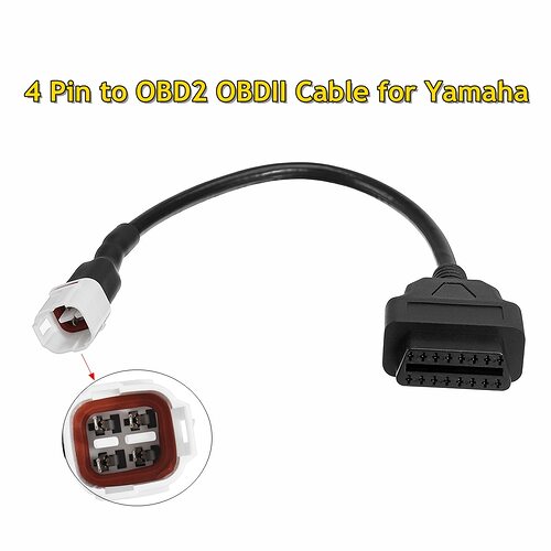

I actually tried seeed studio examples too. But I got nothing other than some strange symbols. On the other hand, I can see that people can connect to 2019 MT-25 via ELM27 with this connector:
