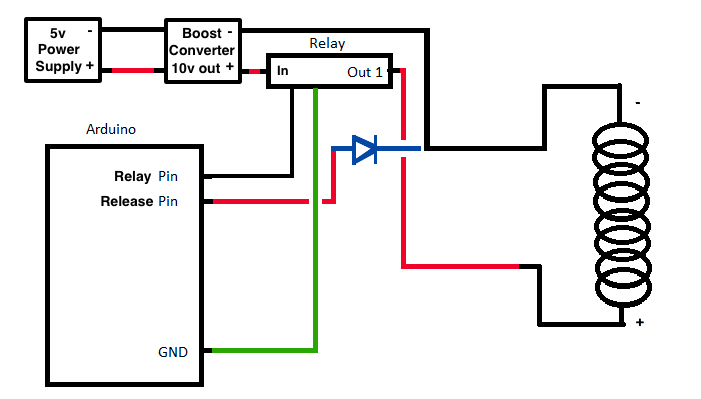

Paul__B ... Is this diagram what you were suggesting?
Gary_Arduino:
Errr, no! That would not do anything.
You could indeed use a relay in this configuration to switch the "hot" end of the magnet between your 12 V and ground if it were not practical to find the enable pin on the boost converter, but I figure what I have suggested is substantially more compact and - avoids the relay (current draw).
OK, you just put the diode in the wrong place. :astonished:

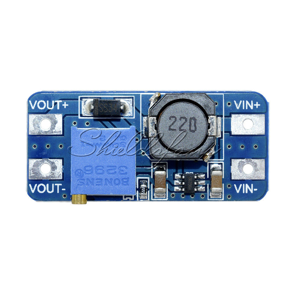

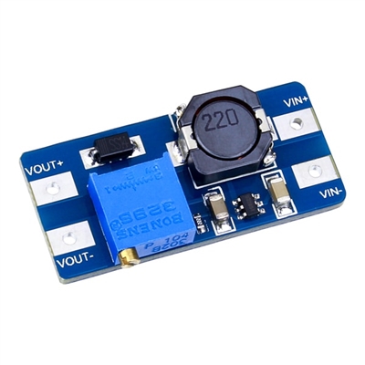

BTW - Here is a link to information about the power booster I am using
I ordered it before I knew even as much as I do now ... which isn't much. It seems to work well but if you needed a very precise voltage it probably wouldn't do the trick.

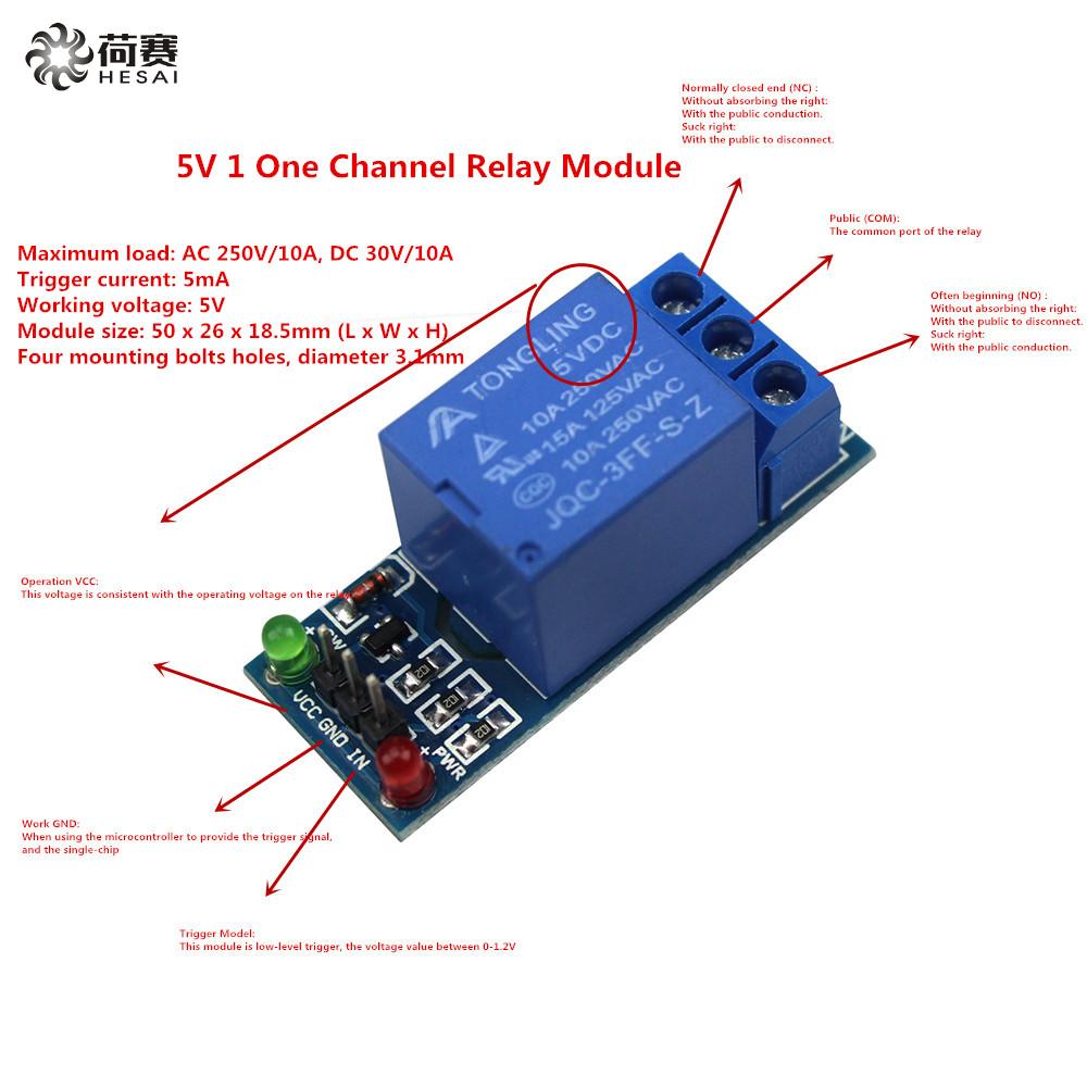

I couldn't find a schematic for the relays I am using. It is the 2PH63091A 2 Relay Module although I am only using one of the relays for the magnet. The other relay is being used to apply completely separate power to something else.
The modules themselves are the JQC-3FF-S-Z
A picture of which is here https://i.stack.imgur.com/TWLit.jpg
but the controller board is different for the 2 Relay Module I am using.
MT3608 Step-Up Adjustable DC-DC Switching Boost Converter – Addicore
But you do not require a precise voltage - that is quite a different circuit. OK, here is your module (from another well-known seller):
If you look at the datasheet, you will note that the enable pin is pin 4 which on the module you have is connected to pin 5, Vin and a simple hack to this module is to cut that connection with a craft knife so that with due care, you could solder the bared end of a fine flexible insulated wire to pin 4 (lower right pin on that image). This is the pin you would connect to your Arduino (by as short a path as possible) to switch the boost converter on and off. Unfortunately, I have just realised that this will not drop the output voltage to less than 4.7 V on a boost converter so we will have to forget that and use the relay! :roll_eyes:
One last thought - the supplier from which you bought that module at least has used capacitors of reasonable size. Hopefully they are the 22 µF specified in the datasheet. I notice many suppliers picture very small capacitors which I suspect are dodgy.

Right. I think from your rather congested photograph that you are using one of these modules.
These are actuated by a LOW level output though you could re-work the connections for a single relay to operate on a HIGH output. This is the schematic diagram:
To use them correctly, you remove the jumper, connect GND and JD-VCC with a pair of wires (in one bundle) direct to the 5 V power supply, connect Vcc and your inputs but not GND to your Arduino which is powered by a separate, bundled, pair of wires from the power supply. A 470 µF capacitor across the relay power wires at the relay board would be a good idea.
