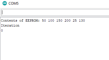

Ok update to last, the loop only runs once which I find it extremely weird
Post latest code.
Post matching Serial output.
Here's the latest code with the debugging lines:

Serial monitor output:
Hopefully, this helps! Thanks!
OK so it obviously never comes back from the first call... like I said... use Serial.println... LOTS OF THEM !!!! You are trying to figure out which bit is blocking...

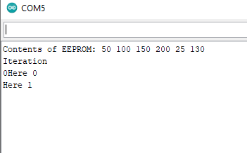

@red_car thanks for your suggestion. I have added in more stuff similar to what you have said but I still can't solve the problem.
I found out where it stopped (refer to comment in code). I have used your code for easy reference.
void digitalPotWrite(int address, int value)

  SPI.transfer(address); //Stops here
  Serial.println("Here 2");
  SPI.transfer(value);
  Serial.println("Here 3");
  delay(100);
  // take the SS pin high to de-select the chip:
  digitalWrite(slaveSelectPin, HIGH);
    Serial.println("Here 4");
Here's the corresponding output of the serial monitor:
Hope you will be able to give me more insights.
SPI.begin();
in setup.
Thanks so much!! Can't believe I missed out on that line.
Remember Serial.println... and a quick google search on "spi.transfer never returns"... you aren't the first, and won't be the last :slight_smile:
