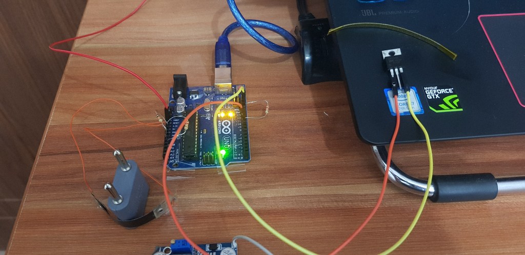

hi, in my project i have small sheet of special alloy that a wire of Ni-Cr is wind around it. by increasing the input voltage to wire, it will be warmer by internal resistance and the alloy will bend. i want to have flex sensor to sense the bending curvature and send it to Arduino to increase or decrease the output voltage to wire. the main source is 10v and 1A. can anybody help me please?

Yaah, every things that you say is true and is my goal. now how i can do it? with arduino or any etc PID control? the flex sensor in flat mode have a about 50 k ohm resistance and in bended mode, 140 k. please tell me what part and circuit i need to control? these pics shows before and after heat and curvature.

OK. i buy one MOSFET IRFZ44N, Arduino UNO R3, I have sensor before. i write the pid controller, i define the pin 9 & 6 as PWM. as the sensor bends, the voltage in PWM pins is changed. i saw it by multi-meter. now please tell me where i must put the MOSFET? in the PWM pin, i can not have more than 5v. i need more about 10v, by mosfet.
Standard MOSFET circuit.
Output pin to the gate; pull-down resistor from gate to GND, load between positive supply and drain, source to GND.

Yaah, I have two heater. i bring every thing that you say to me, but i am week against you in electronic. can i ask you to draw me the circuit?
