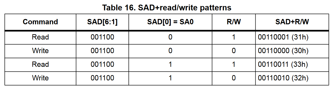

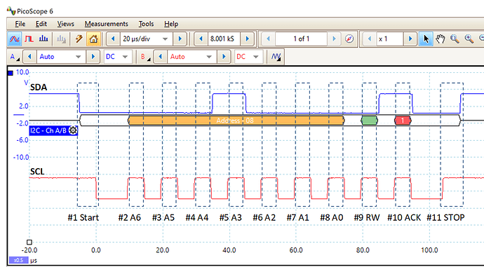

I think it's the usual 7bit address vs 8bit address issue.
This is a scope trace I took ages ago when I first tried using I2C with Arduino. The line of text from #1 Start to #11 STOP is my annotation, not Picoscope's decode.
For the default 7 bit address of 0x19, if we multiply it by 2 we get 0x32, then presumably for some reason they assume it's a read and add 1 to get 0x33.
I don't think so.
I'm a bit confused by your reply. I can't spot my misunderstanding.
The datasheet for the LIS2DH12 contains this table:
By device ID I didn't mean the I2C address, there is a device ID in a register, the sparkfun device ID is 0x33 but the SC7A20 reports 0x11 as its ID,which is checked during the accel.begin function.
