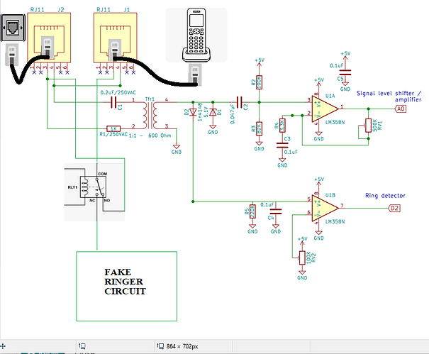

what do you think about adding a relay between the phone line and the house phone.
1--> disconnect the house phone from the line the second a ring is detected
2--> if valid code than stay at the dev kit and use it as smart home hub
3--> if invalid code or no code is entered
4--> put a fake calling signal on the house phone
5--> sense for the home phone pick up hook
6--> if sensed reconnect to phone line
step 4 shouldn't be to hard to create have you got a easy diagram for this?
but step 5 any idea how to sense this action?
and by step 6 would the phone stay connected?
see your modified diagram for more clarification:
That circuit was designed to detect the AFSK encoded callerID bitstream which is delivered between the first and second ring burst. There I also used a software detection of the ring tone, however, I have a newer design (unpublished but actually in use) which provides a more reliable ring burst detection based on an optocoupler circuit which I am attaching.
Having said that, although I believe you could possibly achieve your aims, I would not myself like to make such an invasive change to the architecture of a domestic phone installation. Apart from the technical considerations, you have to consider any rules of your telephone service provider. Also, if you do seize a call to check if it is a special "data" call, you have all the complexity of keeping it on hold, ringing other phones, injecting a signal into the voice path so the caller hears some sort of ring tone, detecting any handset going off hook, etc. etc. so you are getting close to a PBX type functionality as I have already said. Here, I can't help with any detail and it is beyond may area of expertise for public phone systems.
However, if you do want to pursue this, my suggestion is that you start your experiments with simply transmitting tones over the phone line to ensure that you can receive and decode these with good fidelity. You can use DTMF as you originally planned or AFSK.
If you get that far, then you can proceed, offline, to start with of getting the other phones in the house to ring and conduct experiments to detect if these are answered.
