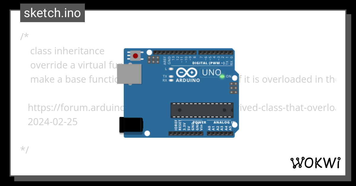

@gchardin
here is an example which shows
  • class inheritance
  • override a virtual function from the base class
  • make a base function visible with USING even if it is overloaded in the derived class
