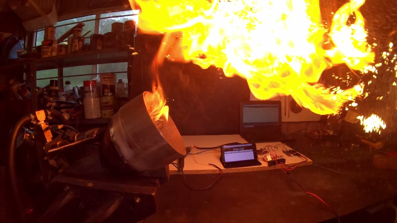

In the sketch, micros( ) is being used for short intervals; you can get outputs as short as ≈ 10 µs and higher.
sorry Larry I did not explain myself very well.
at present the sketch starts both fuel injection and coil charge on at the same time and stay on for their individual setable times then repeats after the setable duration.
what I may have to do is also vary the start times to start the coil charge slightly before the fuel inject.
But as I said I will be testing on my project this evening Cairns Australia Time.

Hi Larry I tried the sketch on my test rig.
Found a problem when the first injection cycle injected for 25ms. the rest as program 5Ms It did give me a direction as the extra fuel did ignite and give a larger flame.
i believe the long first pulse duration issue is the 12v battery which I am using to fire the injector coil, the ignition coil and run the high pressure fuel pump. but also powering the arduino which may be the problem maybe voltage flucuation.

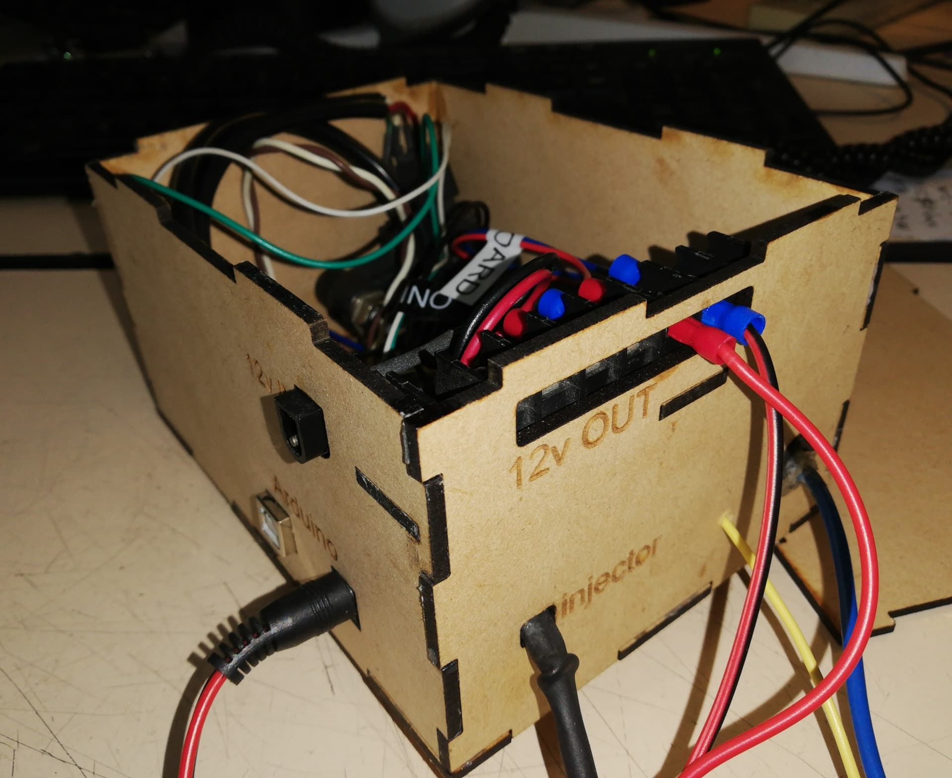

I am going to make a box to put it in to protect it from spark jump to other wires and use a second 12 Battery.
I seem to have damaged another Arduino as The USB not Recognised and flashing 3 times then stop but repeating.
