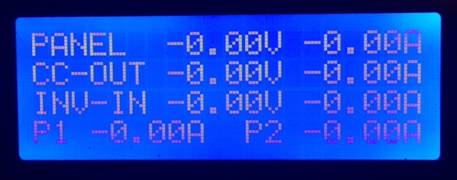

The first two columns after date are the first line on the display below, second two the second line, third two the third line and forth two the forth line which will come from two ASC712 via Arduino analog 0 and 1.
Display:

Ha! the second parameter passed to INA226.calibrate is the max expected current. I had 8, but it is float so should have been 8.0.

You got it Sir, moving the INA226 initialization inside void loop(), modifying and passing the INA226 address in ina.begin(0x44), and repeating it for each INA226 address works.,
