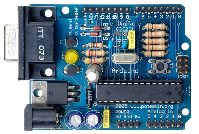

The first Arduinos used processors that did not have USB functionality. So communication with the PC was done using an additional chip; the very first Arduino actually used RS232 (not sure what the model is, see below image), later models are using USB.
 ![image](https://europe1.discourse-cdn.com/arduino/original/4X/2/6/9/269e6f39d20b89ca804a235a74e44439f552a8de.jpeg)
> **[One board to rule them all: History of the Arduino UNO | Arduino Blog](https://blog.arduino.cc/2021/12/09/one-board-to-rule-them-all-history-of-the-arduino-uno/)**
> After more than a decade in the hands of makers around the world, we’re taking a fond look back at the beloved microcontroller, the UNO.
When Arduino started expanding the range, they started making boards with different processors; some of those processors provided native USB. Example boards are the Leonardo/Micro/Due.
If a board does not provide native USB, it depends on the board if the TTL-to-USB converter can be reprogrammed to provide HID functionality. Original Unos and Megas have the 16U2 that is used as a TTL-to-USB converter; it can be reprogrammed to provide HID functionality. A original Nano uses a FTDI chip and that can't be reprogrammed; similar for a lot of Uno/Mega/Nano clones that in general use the CH340 and can't be reprogrammed.
So you are indeed mistaken that every Arduino can act as a HID.
