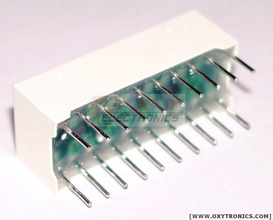

Up to 25 LEDs could be scanned by using 5 pins + 5 pins = 10 pins, so 20 LEDs with 10 pins are possible. You have not told us whether your displays are 10 independent LEDs, 10 LEDs with a common cathode, 10 LEDs with a common anode, or something else.

to answer you vaj4088, this is how it looks:
so not sure how to know if they are independent, common cathode, common anode etc. any hints on how to know that ? from what I see, they are 10 independent, but put together into one "box". I use 10 resistor and it is working.

@UKHeliBob : oh, nice catch ! I must have 2 74HC595 per led bar graph then (unless I use 4 of the leds, for two 74HC595 pins, eg. the two lower would always lit together, and two higher too).

I hope I can desolder their ledbar and put mine as mine have 5 green, 2 orange and 3 red, which I prefer to theirs (7 green, 1 light green 1 orange 1 red I think). Do you think that might be possible ?
