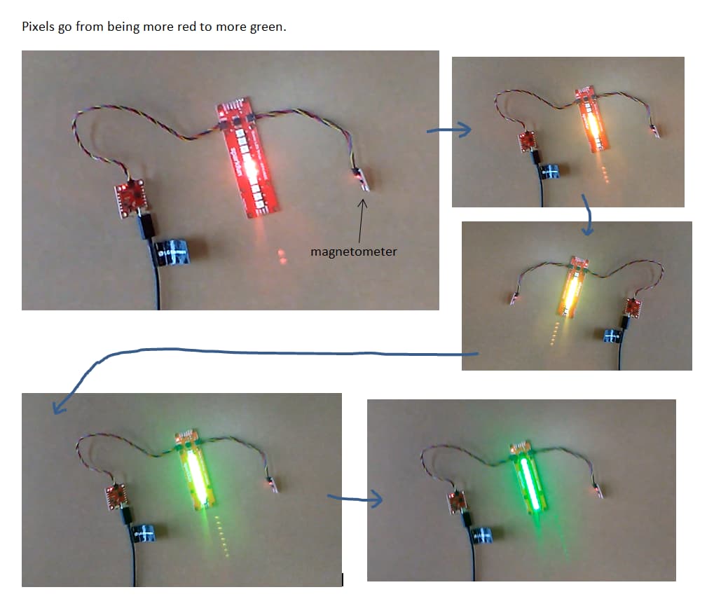

The LED stick isn’t doing what I want it to. I try to get the pixels on the stick to change color, using a switch statement. In the sketch that is below, I describe my problem in more detail, in the comments above the for statement.
//  Supposed to use arrays with ten elements to change the color of each of the ten pixels on a LED stick.
//  modified from Ciara Jekel's I2C based LED Stick
#include "Qwiic_LED_Stick.h" // Click here to get the library: http://librarymanager/All#SparkFun_Qwiic_LED_Stick

  //Create 3 arrays the same length as the LED stick.  There are 10 pixels on the LED stick, which is why 10 is between the brackets.
  byte redArray[10];    //will store how red each pixel is.
  byte greenArray[10];  //will store how green each pixel is.
  byte blueArray[10];   //will store how blue each pixel is
  /*  The problem in a forum is described in more detail here.
      I make what the variable "angle" equals (at different times) come from a for statement instead of a magnetometer, to keep the sketch shorter.
      As far as I can tell, the results are similar to the results from the magnetometer.
      Some of the pixels are different colors from the others.
      But I wasn’t trying to get that combination of colors, ever.
      And I was trying to get the colors to change, but they don’t look to me like they are changing.

Did you get the Serial working?
What does it print to your monitor?
I do not see any obvious problems.
Use of String is not recommended on small mcu's.
Instead use a for loop.

Can you share a picture of your setup?
If you plan to add more
Like this? It started working when I did it this way.

Would what it prints still be useful, now that you have the picture?
What do you mean?
Thank you.
What is while(1); supposed to accomplish?
The for is almost like that. But you should start at 0, not at -1. Where (in mcu memory) do you think element -1 of your array is?
Serial is always useful during debugging. It can tell you where the program goes and what intermediate values it calculates.
'If you plan to add more" is probably a relic of a sentence that I copied and pasted somewhere...
By the way, you can reuse i (instead of the complete alphabet). i is often used as a counter to run through array elements. If the array is 2D you would use i and j.
I’m not sure. I didn’t write it. Maybe it pauses, because there is a problem. I’ve also seen while (true);
Is the lower of the last two for loops better than the upper of the last two?
