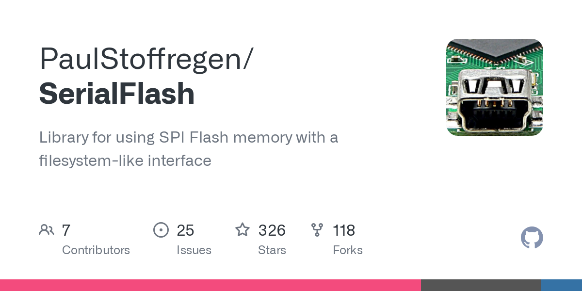

I want to implement cyclic recording where the older files gets deleted automatically when storage is more than 75% full
Have a look at
There are some limitations with this library, but for what you want, I think it will be fine.
You need to create the empty files first. You could create 31 empty files each of say 32kb which would give you plenty of overhead on your 5Kb.
You could even create 365 empty files that size - depending on the W25Q device you have. All file are created "empty" and space allocated for them on the flash device. You simply open the file and write to it.
There is a file erase too but note that the actual file isn't erased (i.e. you don't get your space back) but it is marked empty for you to write to it again.
