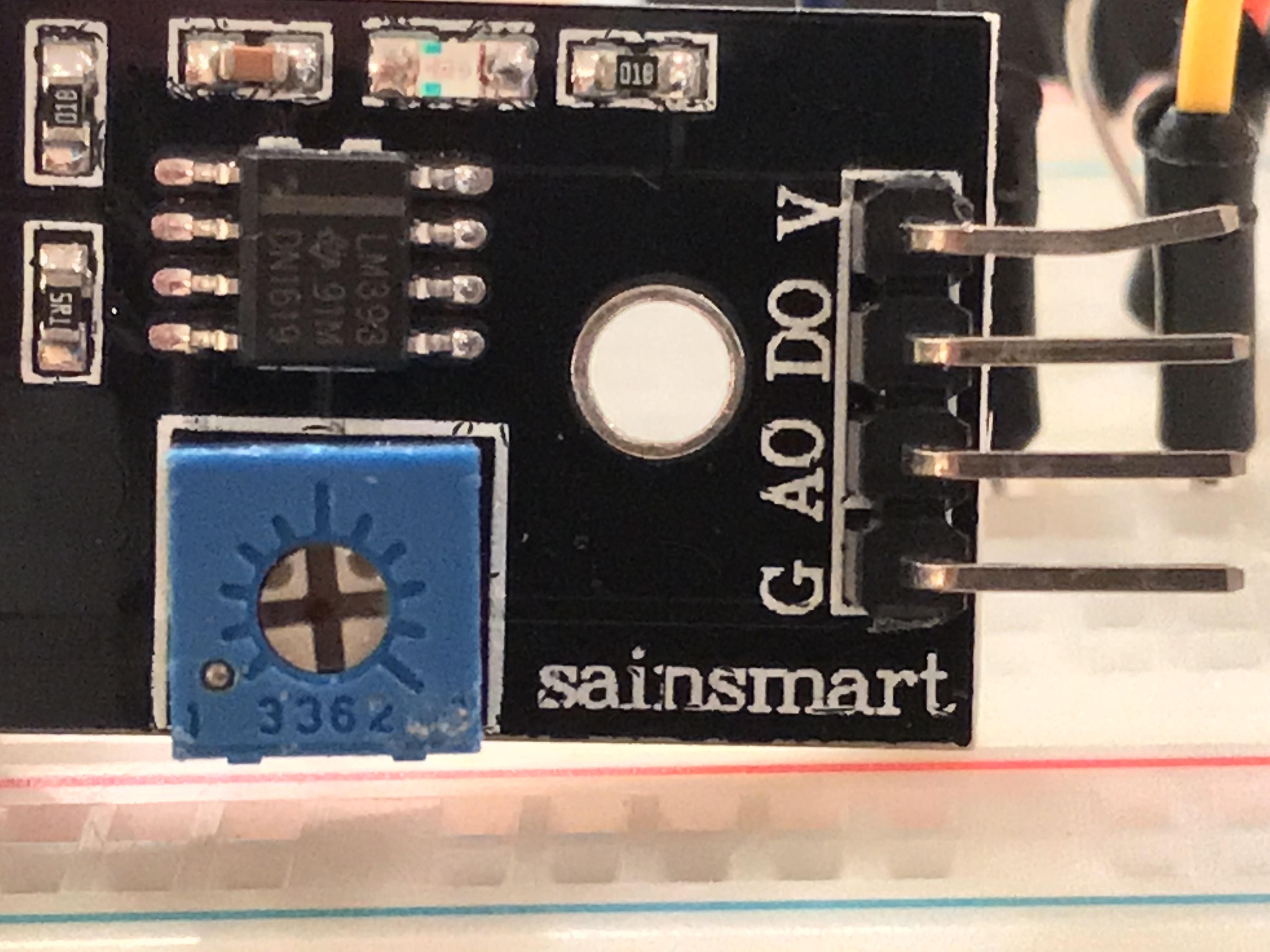

I just received a SainSmart MQ136 Semiconductor Sensor for Hydrogen Sulfide, which is a sensor attached to a little board. This is different from a lot of the gas sensors I've seen online that don't come with the board. I'm not exactly what this is called and what purpose it serves, but I guess it contains things to make it easier to use.
It also has a potentiometer on the back, but since I can't find a datasheet, I'm not exactly sure what it is for. It has 4 pins and I'm assuming they are for:
G Ground
AO Analog Output
DO Digital Output
V Voltage
I'm trying to measure when hydrogen sulfide (stinky!) is detected. The higher the concentration, the more an LED blinks. Besides trying to find out what the pot is for, I'm trying to find out the high and low "temperature" ranges this produces so I can adjust my code to blink slowly when there is less HS detected, and more when it is higher. I initially built this with a regular pot in place of the sensor and it worked nicely. When I run this now, I'm getting analog readings of around 420, but it never changes much in either direction. Maybe 395-430.
Any idea on how I can find the datasheet for this and understand the AO output (min and max values)? I've removed the LED code for brevity.

There's a pot.
The description on the Sainsmart page mentions that the load resistance is "adjustable" - making that the only candidate for that pot, and the pot the only candidate for this "adjustable" resistance.
The MQ136 data sheet is easy to find - do some trace following on the PCB. Quite sure that pot is the adjustable load resistance.
I do agree that it's not good of Sainsmart to not add a proper datasheet/manual with their products.
MQ136 data sheet.
The "A0 output" doesn't mean much unless you have (1) done a "burn in" of the required length, up to 168 hours for a sensor that has been stored for months and (2) calibrated the output using a known concentration of H2S gas in dry air.
However, the output can alert you to changes in the H2S concentration -- or possibly, some other gas (including humidity changes), as these sensors are not very discriminating.
Here is a great general tutorial on using the MQ sensors.

I assume all I need to do a burn in is to have the sensor powered up for the burn in period, correct?
x=analogRead(analog_MQ136); //read the sensor
What unit is x? e.g. assuming the sensor is burned in, and operating conditions are 20C and 55RH, if the code above is ran and x = 429, what is the ppm of H2S the sensor is detecting? I suspect I need something from here.
Unfortunately the DS has a few problems, like the following truncated text.
NOTE: The change of Output voltage( △ Vs) is the difference value between VRL in test environment and
This leads me to beleive x is a delta voltage from the VRL. Is the VRL based upon the the potentiometer setting and 5V? According to the DS the load resistance (Rl) is adjustable, and being the pot is the only adjustable component, how does one know what each setting on the pot is doing? Is there a way to hook up my MM and know what’s happening when I spin the wheel?
The result from analogRead() is a number in the range 0-1023, and has no units as such.
The only way to link this reading to an actual gas concentration is to calibrate the sensor using known concentrations.
