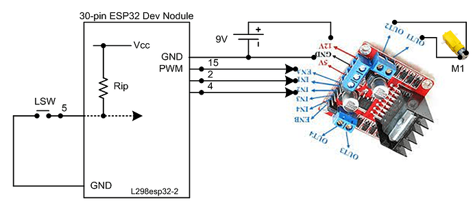

Im currently doing a project that uses esp32, l298n motor driver, limit switch and a bipolar stepper motor. Im able to make the stepper motor spin one time every time the limit switch is pressed. I need help for the coding. I want the serial moniter to count every time the motor spin, for example the limit switch is pressed one then the serial moniter shows number 1, and when the limit switch is pressed again the serial moniter shows number 2.

Post your code and a schematic of what you thing you are going to use as your hardware setup.
Is your hardware setup similar to Fig-1? If not, tell the differences.
Figure-1:

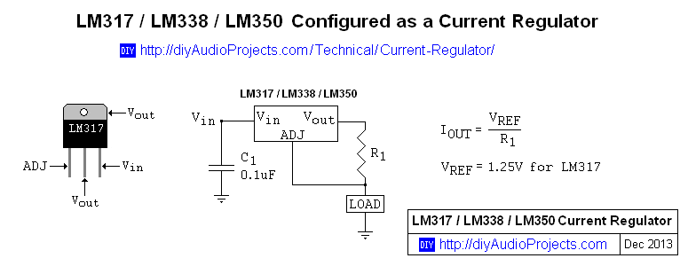

why not use a current regulator which will provide whatever voltage is required to maintain that current?
Because, as I said, that limits the speed / torque of the motor.
Have you ever used stepping motors in anger?
a current regulator would provide higher voltage initially, up to the current limit, and reduce the voltage to maintain the current.
wouldn't that maximize torque?
Nope that is not how current regulators work, unless they are chopping current regulators, which is what I recommended in that link.
Can you give me an example of the sort of current regulators you are thinking about here please?
that may not be what you are trying to describe, but that's what a current regulator does, it provides a varying voltage to maintain a constant current
LM317-Current-Regulator
Yes but it will not work correctly in a stepping motor circuit. By correctly I mean supply maximum torque / speed.
what does an electronic circuit need to do to provide max torque?
