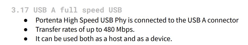

So in the data sheet it mentions that the USB-A port can be used in both host and device configurations. I found code on the official Arduino GitHub page for the Portenta Machine Control (Arduino_MachineControl/USB_host.ino at master · arduino-libraries/Arduino_MachineControl · GitHub) to turn it into a USB host. How would you configure the port to act as a device, or is it by default already configured as a device?
I would also like to know how to set this up as device instead of host.
I have the same question and I see this thread is open for months with such a simple question and no answer... too bad the developper fail to document.. or even reply to such a question... I tried to open Serial 2 and Serial 3 but it doesn't seem to work...
