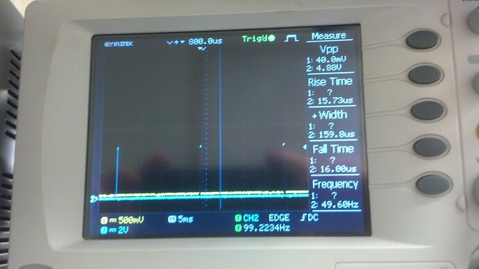

Hello all,
Long story short, I want to write my own code to do PWM on pin 9 of an Arduino Ethernet. I've been reading a lot of the ATmega168/328 datasheet sections that deal with PWM - especially PWM on Timer1. I want to control a serv with a refresh rate of 200 hz (I called the company and they said their servo can refresh anywhere from 50-250 hz and the faster the better). I currently believe I have code written to output at 50 HZ. I'm using the phase and freq corrected PWM with ICR1 as my TOP for PWM.
Registry in Binary
TCCR1A = 1 1 0 0 0 0 0 0
TCCR1B = 0 0 0 1 0 1 0 0
This gives me
WGM1 = 8 - Phase and freq corrected PWM with ICR1 as top
COM1A = 3 - inverted PWM
CS = 256 - prescaler used to give me 50 Hz (Question about this at the bottom of the post).

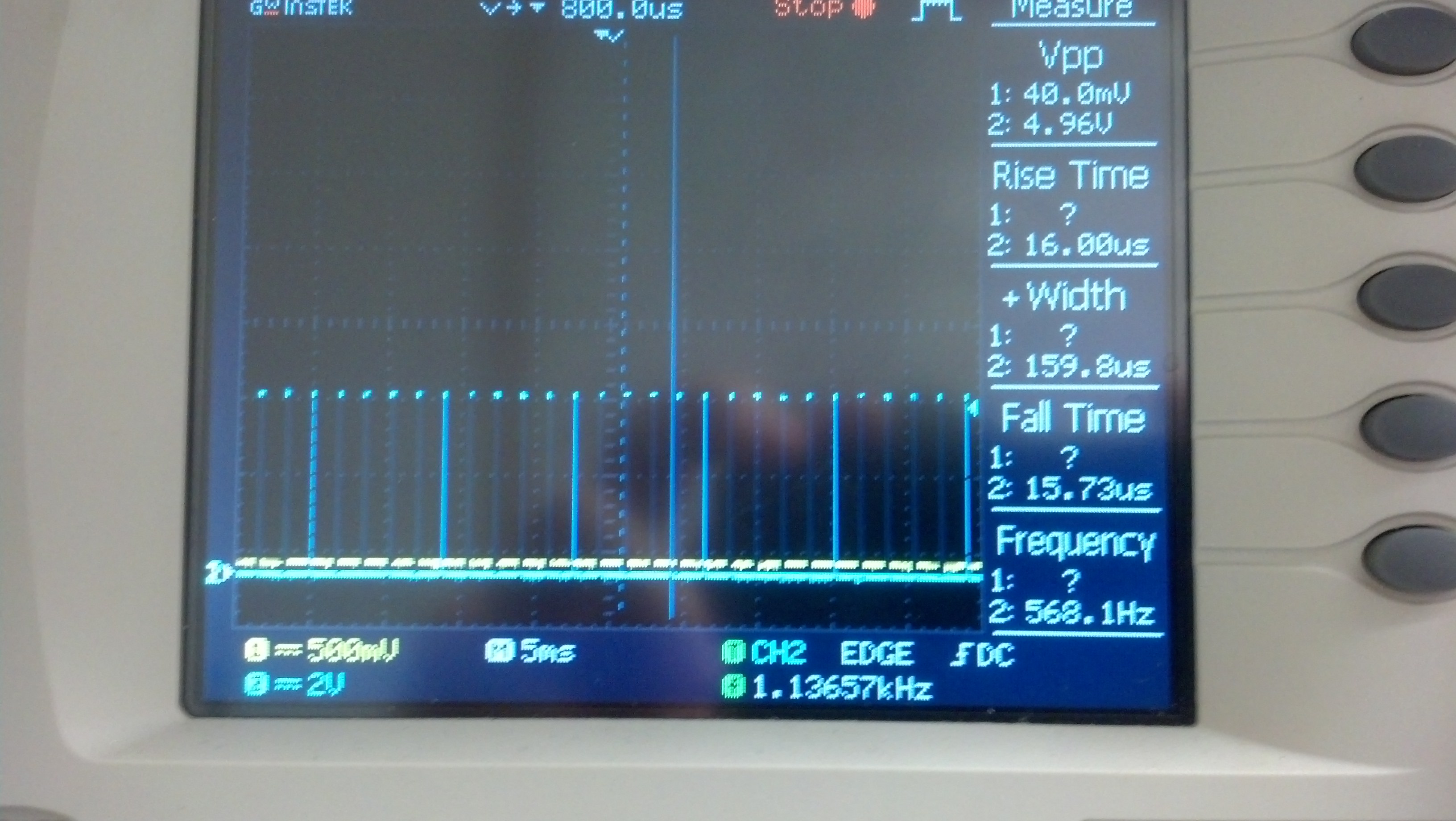

When I hooked up an Oscope to pin 9, I saw a pulse width of ~150us at ~50Hz. I then set OCR1A = to 100 and I noticed that my freqency of said pulses increased from 50 Hz to 100 Hz but the pulse width did not grow larger - it was still ~150 us. I thought that pin 9 was supposed to go high when TCNT1=OCR1A on the upcount and go low when TCNT1=OCR1A on the downcount, thus giving me PWM. I was going to vary OCR1A to create my PWM.
Everything that I've read says the COM1A will determine what happens on the OC1A pin - pin 9 - and the PWM isn't showing up like I thought it would. What exactly am I missing here?

The register settings look correct to me, although I would not enable the interrupt is I wasn't going to use it. You don't show the code where you changed OCR1A. If you changed ICR1 (TOP) accidentally, that would change your frequency

So to change OCR1A, i just wrote it in the code. The first image attached will be OCR1A = 0
 TIMSK1 |= (1 << OCIE1A);
  OCR1A=0;
  sei();//allow interrupts
The second will be OCR1A = 100.
  OCR1A=100;

So I changed where Im updating OCR1A. Originally it was in the setup mode, but that gave me my problems. I didn't have interrupts allowed when I was updating. Does OCR1A require an interrupt to update? I want to say yes, but I'm not posative. Anyways, I added this as my loop and I'm getting somewhere now :smiley:
