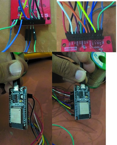

Followup on my query.
I have two ESP32 boards:
  1. ESP32 DevKit with 30 pins
  2. NodeMCU-32S board with 36 pins
We broke our heads for weeks and couldn't get the LCD working with board #2. We connected Vcc to 3.3V pin. When we tried to troubleshoot, we saw that as soon as we connected the LCD module to the board, the vtgs on Vin and 3V3 pin almost disappeared. We couldn't get any further with the troubleshooting so we just tried the board #1. And Voila! Immediately the LCD lit up.
Now we couldn't figure out why board #2 was not working and didn't want to spend any further time on it so we continued with board #1.
So LCD is now working, but unfortunately we can't get the touch to work.
Here's what we did:
  1. Connected SCK <-> T_CLK <-> ESP32_PIN18
  2. Connected SDI(MOSI) <-> T_DIN <-> ESP32_PIN23
  3. Connected SDO(MISO) <-> T_OUT <-> ESP32_PIN19
  4. Connected T_CS <-> ESP32_PIN21
This, along with the existing connections for the LCD part.
As soon as we powered up the board and the LCD, things went blank on the LCD. Just the backlit.
I'm suspecting we're doing something wrong with the connections. Would someone be so kind to help us out here? Might be if we can have the ckt if someone has already made this work? Would be of immense help.
Regards, Deepak

Go on. You should connect (Slave) SDO and (Slave) T_DO to (Master) MISO And SDI, T_DIN to (Master) MOSI
MOSI means Master-Out, Slave-In MISO means Master-In, Slave-Out
Your User_Setup.h "looks" ok. Especially if all the examples display correct colours, directions, ...

We really need to see a real photo of your wiring. I am 100% certain that Bodmer's wiring is 100% tested.
I can only report my experience i.e. my wiring works for me. I use the same wiring with ESP8266, Teensy3.2, Nucleo, ...

So i tried below:
  1. Did the connections again for LCD and touch. See attached.
  2. Ran the Read_User_Input example and got the output below

I would not expect anything from your photos. Please post a clear photo showing coloured wires mating with named ESP32 pins.
Although I don't like breadboards, you could plug the TFT into one side with the ESP32 plugged into the other side. I would trim solid coloured wires to connect neatly between TFT and ESP32. Take a photo of neat wiring. Every reader can check your wiring.
At least you have a 3.3V screen with a 3.3V ESP32. Much better than people fiddling with 5V Uno and level shifters.
Personally, I make custom shields with Protoshield pcbs with soldered headers to receive the TFT. I can then use the "custom shield" with any Arduino-style board e.g. Due, Zero, STM32, ..., TTGO ESP32, R1 D1 ESP8266
David.

Think about it. Random jumper wires with loose connections will never work reliably.
Use regular square header pins with mating sockets. Stationary solid-core wires are fairly good. Or use soldered wires which should be the best.
Remember that the ESP32 is a fast processor. It will respond to glitches that a 16MHz Uno would ever notice.
David.
So keypad worked as well.
I think I know what happened. Since the code wasn't working on the 36pin version of the board, we kept trying different things, one of them being changing the SPI frequency.
About the wiring. We tried the breadboard initially, but with the 36pin board. And the code was still not working. Hence to eliminate any breadboard issues, we decided to hard-solder the pins. And hence we used male-female berg jumpers to do the 3 SPI connections from the LCD part to the touch part. To ensure the connections were clean, we soldered the male part of the berg pin to the board (LCD pins), and the female part slid easy and clean on the touch part. Didn't leave any possibility of a bad connection/connector.
When we used the 30pin board, all worked ok as it was supposed to be.
Apologies if this thread led to nothing. Thankyou David, ketineni and Bodmer himself to have made our lives a luxury by providing this library.
