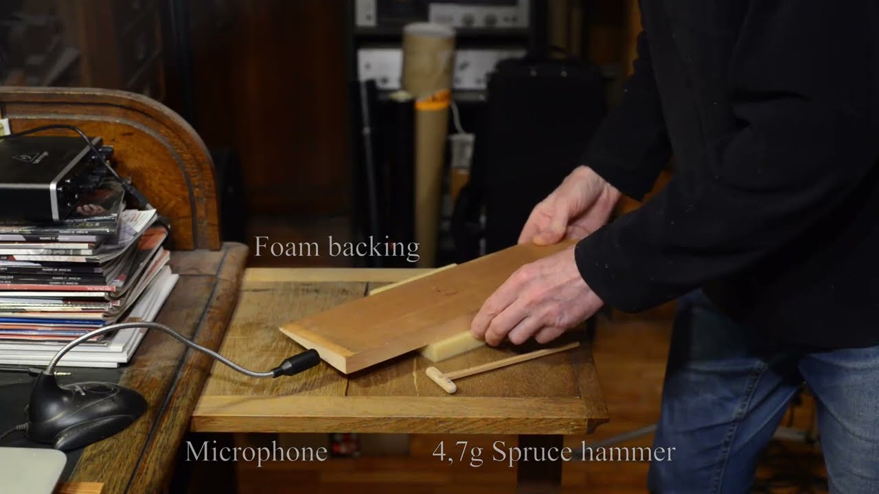

Just use a spring mechanic that knocks on the trunk. This generates way enough overtones. BTW, this is used in oil exploration, too ... and by mechanics and handymen and dendrologists. Well, they usaly use a small hammer and a stetoscope for this.

I'd be surprised if you can generate enough energy to propagate ultrasound in a tree.
Lower frequencies have been used for similar applications but unlikely to give clear detail
