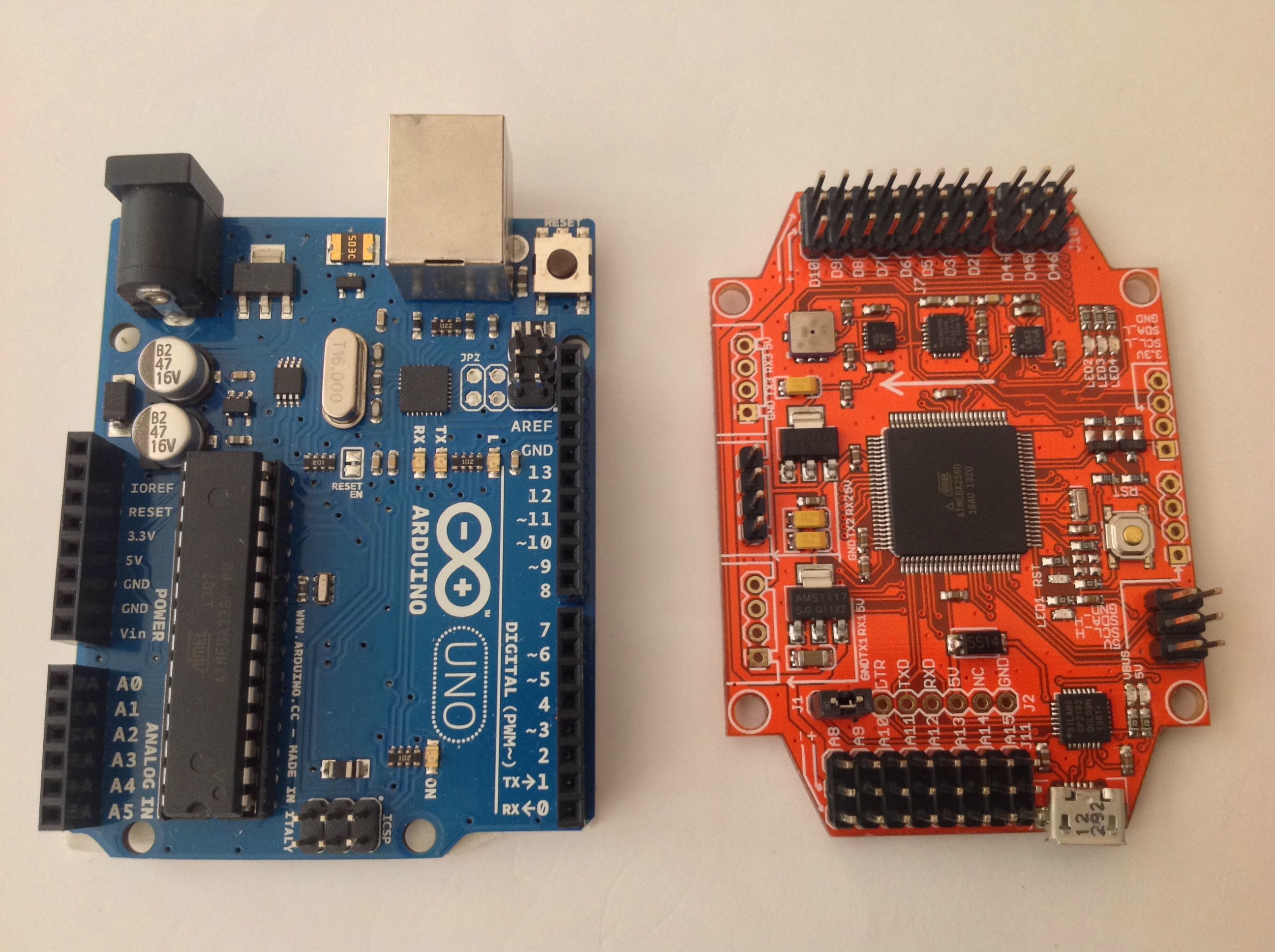

Following up to this post, is it possible to send/receive data/instructions an arduino UNO with a multii wii Pro board?
![](http://)
Imgur
