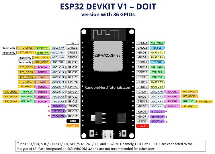

Some ADC pins are not usable when WiFi is used. Try using GPIO36, 37, 38, or 39.
Any ADC1 pin should work
I use ESP WROOM 32
I'v tried but the result is negative

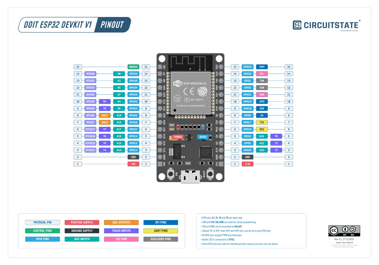

Did you change both the UVOUT and REF_3V3 pins to one of the ADC1 GPIOs?
Which pins are ADC1 are shown here
https://docs.espressif.com/projects/arduino-esp32/en/latest/boards/ESP32-DevKitC-1.html

They are ADC2 pins.
ADC1_CH0 (GPIO 36)
ADC1_CH1 (GPIO 37)
ADC1_CH2 (GPIO 38)
ADC1_CH3 (GPIO 39)
ADC1_CH4 (GPIO 32)
ADC1_CH5 (GPIO 33)
ADC1_CH6 (GPIO 34)
ADC1_CH7 (GPIO 35)
ADC2_CH0 (GPIO 4)
ADC2_CH1 (GPIO 0)
ADC2_CH2 (GPIO 2)
ADC2_CH3 (GPIO 15)
ADC2_CH4 (GPIO 13)
ADC2_CH5 (GPIO 12)
ADC2_CH6 (GPIO 14)
ADC2_CH7 (GPIO 27)
ADC2_CH8 (GPIO 25)
ADC2_CH9 (GPIO 26)
correct.

Follow my instructions in post #8 regarding using analogMilliVolts and the ADC1 pins
The ADC1 pin selection is given in the linlkI provided in Post #7

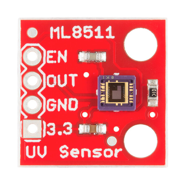

it's work, but so I just use 3 pin from the sensor, right?
Not sure what you mean by 3pin?
Connect 3.3 to esp32 3.3V pin
Connect Gnd to ESP32 GND.
Connect OUT to ESP32 ADC1 pin.
You can leave EN disconnected.
yeah I do that, 3.3, GND, and OUT.
That is all you need.
