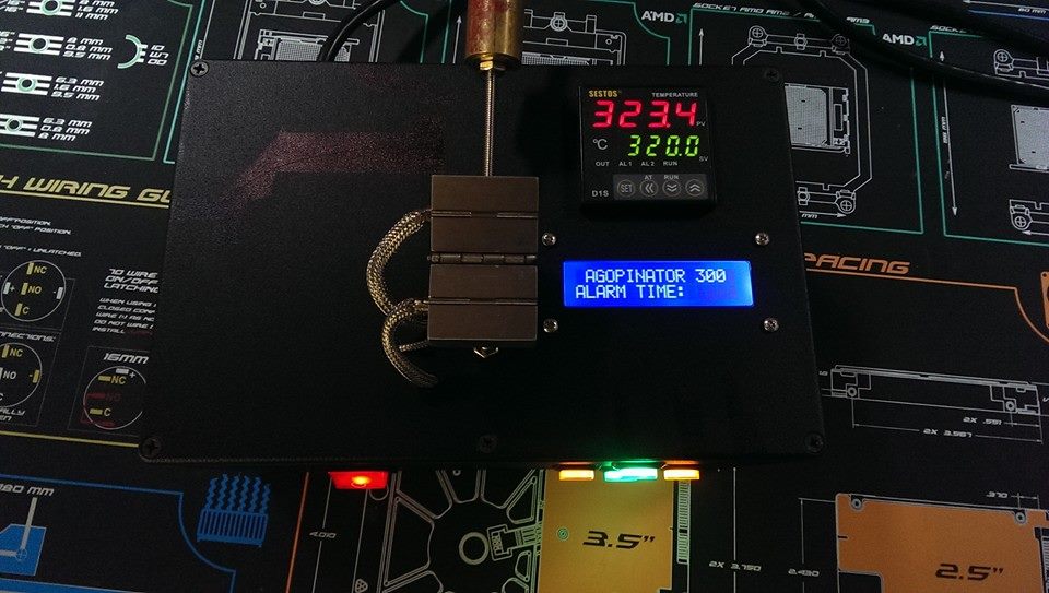

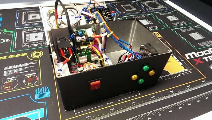

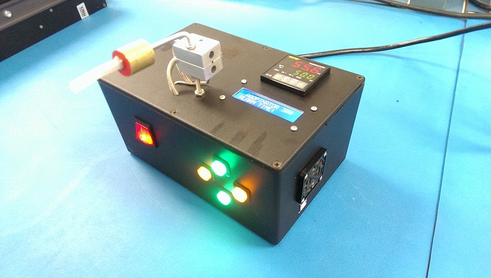

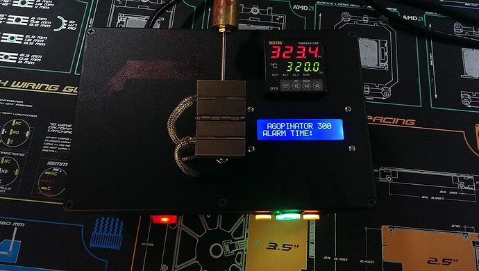

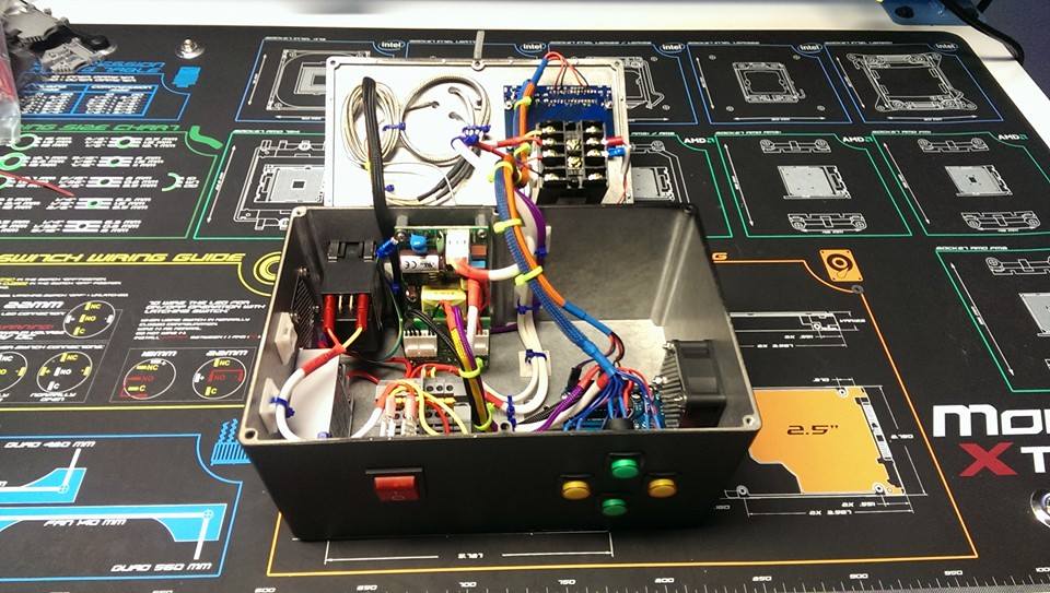

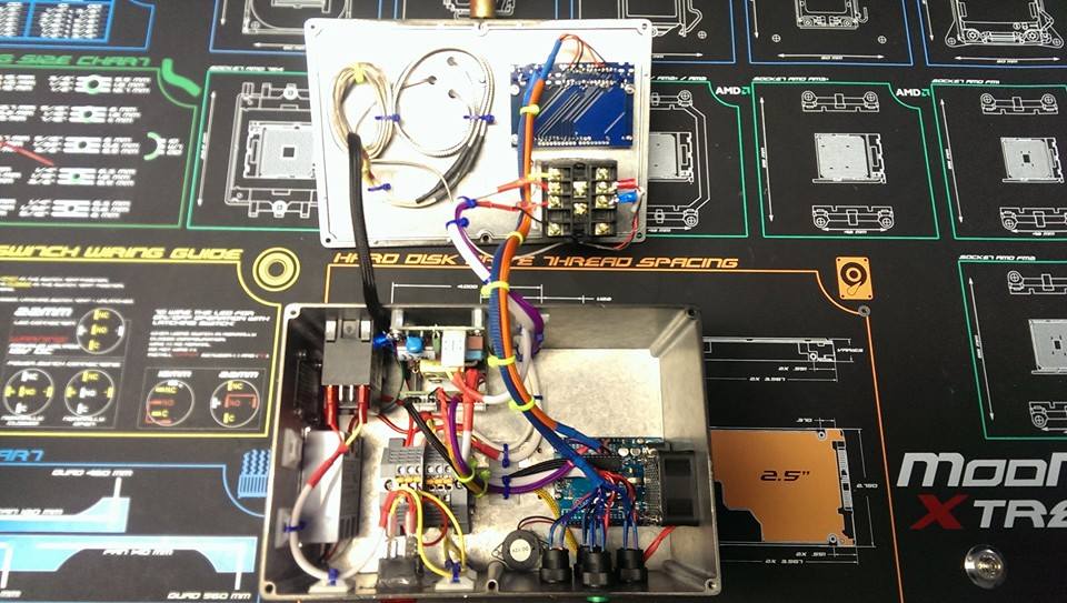

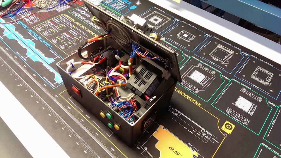

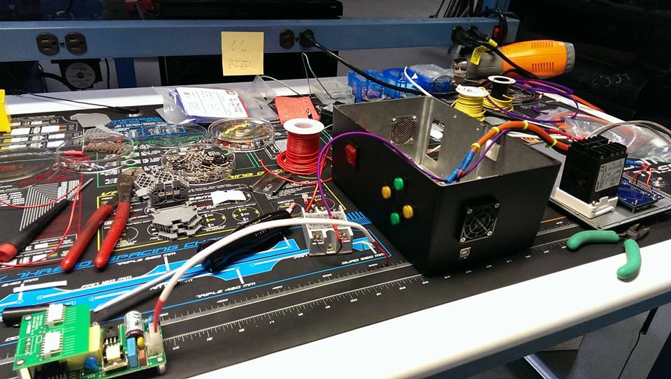

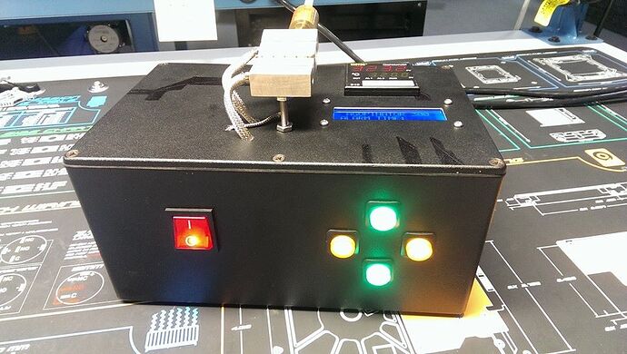

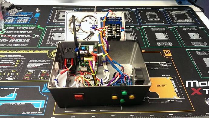

OK people, here are some pics of the final build, sorry for posting pics so late, been busy at work and getting back to school stuff,
more pics :smiley:
