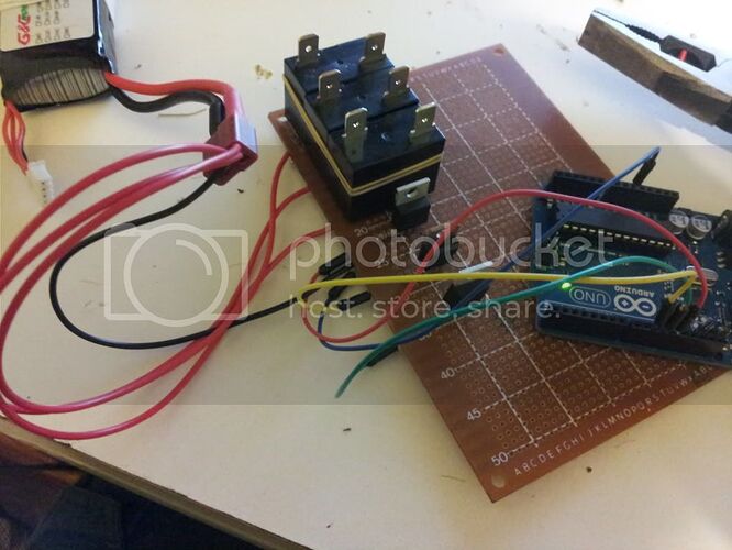

I bought a large prototype board, some proper relays & more transistors.
This is what i've come up with so far.
And here's the really basic code, i used a basic serial input code i found at ladyada then tweeked it to what i needed, basiclly, if it gets any input at all from serial, it will fire the code.

Obviously i havn't yet added any components or code for the sensing of the key, nor the ignition (car has started, switch off ignition)
As far as the sense for when the key has been switched on, i was going to use the idea given above, have the arduino's power source on a normally closed relay attached to the on position of the car, so when the key is switched on, the relay becomes open and the power to the arduino is cut off - this way requires no code.
As far as the car goes, it doesn't require any throttle to start, ever.
And as for the ignition sense, in the fuse box of the car is a 'charge' fuse (from the alternator regulator), that's only outputting 12v once the car has fired. today at jaycar (Australian electronics store) i mentioned the project to a staff member, and he suggested using a voltage regulator, he sold me a 7806CT. he said, it'l step the 12v from the alternator regulator down to 6v which according to him is safe for the arduino input..
Now, can the arduino sense that "okay, 5v has been applied, i'll wait 200ms just to be safe, then switch off ignitionPin" i'm 99% sure that can be done, but what code would i add for this? and also, would i be using the analog pins? or digital pins and have one for the +5 set to input?

Well, yes, i bought a 6 volt regulator. in the car's fuse box, there's a fuse for the alternator reg, that's only hot when the alternators outputting a charge, i've disconnected the fuel pump and attempted to start the car to check this.
i was going to put the 12v regulator in between that, and the arduino input pin. is 6v safe for the arduino "in" pins to handle?
And the code for that would also protect from firing the startor motor again such as giving it a way of checking before doing anything that the car's not running.
"am i getting an input from alternator?, yes i am, so don't allow the following code to be run"
Cutting power to the Arduino seems excessive. I wouldn't do it that way. Just control the starter and ignition relays in a sensible way. Use a state machine to track your status (idle, starting, retry delay, running, etc..)
If you're planning to run the Uno (rather than build your own breadboard/stripboard Arduino), it has a regulator built-in. However, dropping 12-14v down to 5v (onboard regulator), or 12-14v down to 6v (external regulator) involves quite a bit of linear regulation. I.e., heat, and wasted energy. I don't know exactly how long it'll take to drain a car battery -- probably a while -- nonetheless, it's not optimal, and will get quite warm.
Don't cascade those regulators, btw, as 6v isn't a good margin for the onboard regulator. Although, I don't know how comfortable I'd be passing 6v directly into the 5v input either. Basically, the LM7806 is not a great fit here at all. No linear regulator is, in fact. I would strongly encourage looking into switching regulators.
Now, all of the above is nearly a moot point in that you need significantly more filtering to run reliably from an automotive power system than from AC, batteries, or USB. I posted in another guy's thread here about the ignition sequencing computer he wants to build. The gist being, car power is dirty. There are lots of articles and forum posts on the topic, so start looking into it before you button this thing up in your car. Consensus is, a simple regulator and protection diode are not adequate. Be prepared for high voltage (50v typical, 100v+ common enough) spikes, negative voltages (hookup errors or coil transients), brown-outs (starter), and lots of noise.
Don't forget a fuse!
Oh, and definitely don't hook up anything from outside your stripboard straight to I/O pins without protection. If you can't isolate it entirely, then current limiting, reverse-polarity protection, under/over-voltage shunts, an inductor (if you can low-pass your input signal that much) would all be a good idea.

Well, the way i've currently wired it, the arduino and relay coils get their power straight from the battery, and the arduino has a 6v reg to step down from 12v, the bloke at jaycar said that the reg has inbuilt thermal and reverse polarity protection and should be sufficiant to protect the arduino from abnormalitys.
I've used a very expensive multimeter, which has a .01 sec refresh rate and also logs. i had it on the car battery whilst starting it, and the highest it jumped to was 14.8v half a second after starting. then back down to around 13v.
The only other option i was thinking of doing was having the arduino's power supply running from a seperate li-po battery, as i have plenty of these, could hook up a recharger that recharges the li-po's when the car's running.
thus eliminating the arduino's power supply completly from the cars supply.
As far as having a normally closed relay between the arduino's power supply and the "ON" key wire in the car, i thought this would be adequet enough and 100% safe as it kills the arduino's power completly, and as i mentioned in my first post, i'm sort of new to this field, so i thought this would be the best start point, i suppose eventually i'll move up to a state machine.
As for the fuse for the arduino's power supply, what's the rating i should use?
Or, how about a relay that grounds out the reset button?
