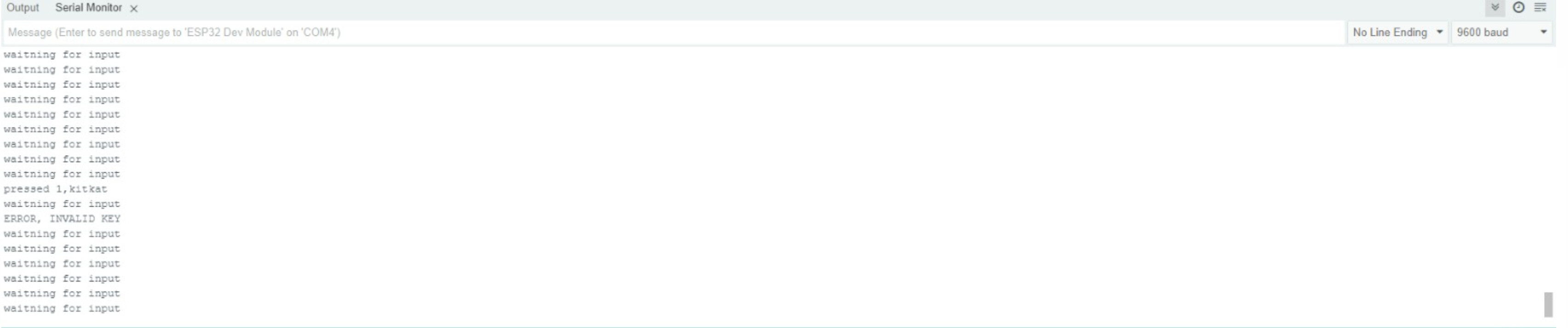

when press 1
get
waitning for input
pressed 1,kitkat
waitning for input
ERROR, INVALID KEY
waitning for input
ERROR, INVALID KEY
waitning for inpu
press 2
waitning for input
pressed 2,kinder
waitning for input
ERROR, INVALID KEY
waitning for input
ERROR, INVALID KEY
waitning for input
why the else statement gets executed?

hey
sorry for the misfire from before.
and again thanks. the sketch we worked on works.
also learned a lot in the process.
so again thanks.

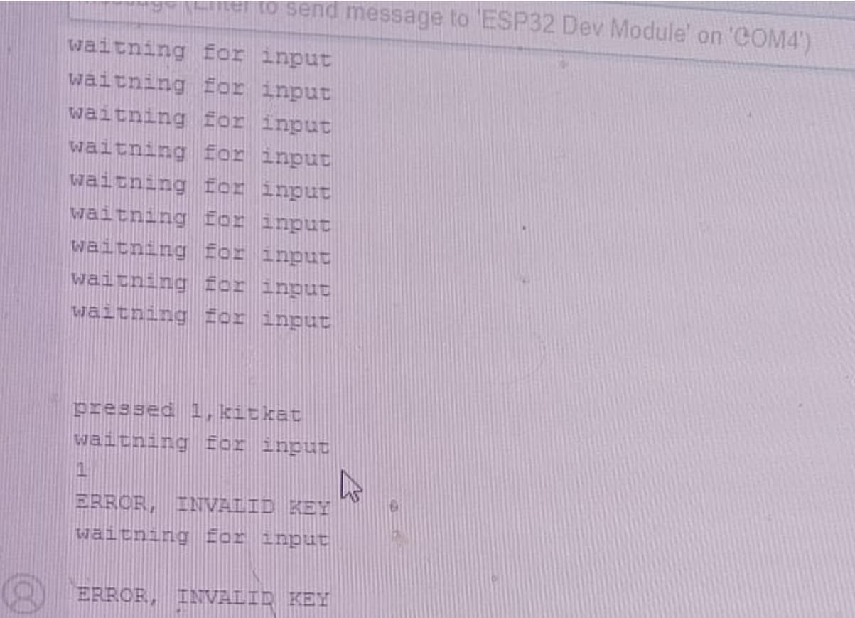

truth be told its a friend thing and he has a problem with the screen capture so
he sent this
language barrier
we working this bottom up. starting with BT.
basically thats it. for now.
and screen cap of the serial monitor including the code?

and getting
pressed 1,kitkat
waitning for input
1
ERROR, INVALID KEY
waitning for input
waitning for input
waitning for input
it was one less ERROR message , but still there.

here the log with the setting
hope thats what you meant.
And now you've gone to changing random things and getting the issue even more confused.
