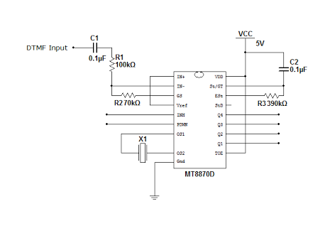

If this is prerecorded sound, tape the sound on one stereo channel and DTMF tones on the other.
You will have to do this simultaneously.
While listening to the sounds, you will have to generate the tones manually as you want them.
Lets say you are using the 16 DTMF tones.
#1 starts the mouth moving
#2 starts the head moving
#3 starts both the mouth and head moving.
#4 blinks the left eye
#5 blinks the right eye
#6 blinks both eyes
#7 lifts the left hand
#8 lifts the right hand
#9 fifts both hands
#10 turns all the motors
#11 blows smoke out the ears
#12
#13
#14
#15
#16
Eye think you get the eyedea.
Next play the stereo sound back with the sound going to an amplifier.
The DTMF tones go to a DTMF to binary converter, then to the controller, then to the motors.
The motors will be in sync with the sound each time the tape is played.
DTMF receiver:
You can find DTMF hand held transmitters on eBay.
