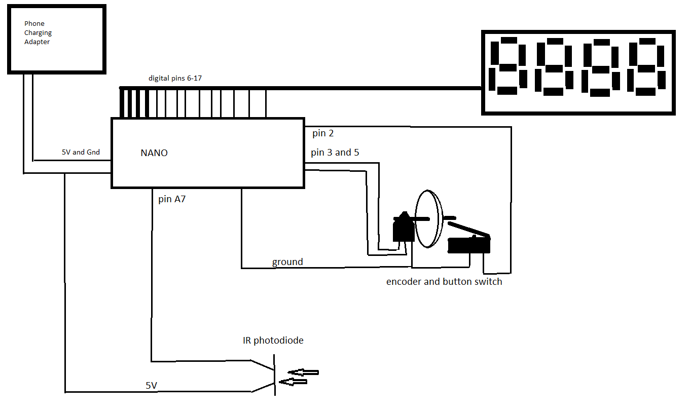

So I am getting some pretty weird readings from the 10-bit analog converter built into the arduino Nano.
I am taking readings from a photodiode and inverting that value with map() so it goes 0->1023 to 1023->0. I do this because the other pin is connected to 5V.
The values seem good for the first few reads and then all of the sudden o get a stream of Zeros and after that its back to the low level noise I expect. Has anyone ever seen something like this before?

Please post a circuit diagram (hand drawn, not Fritzing) and the code, using code tags.
The impedance of the source connected to the ADC input should be less than 10K Ohms. Normally with a photodiode, one uses an op amp as a current to voltage converter and to lower the source impedance.

The circuit you posted is not accurate or very useful, but the basic approach won't work at all.

A correctly drawn circuit would have been useful.
For example, you could identify positive and negative power leads, component leads, etc.
The only concern of this thread is to figure out why the ADC is giving false readings at very regular intervals.
This is because the circuit you are using will not work at all. The ADC is always giving "false readings".
Looks like your sensor is slamming up to full voltage (5V?) , 1023 ADC counts and your map is flipping it to zero. What do you read on pin A7 with a voltmeter?

Hope you weren't expecting a read out of degrees Fahrenheit with the photodiode hooked up like that. :slight_smile: Needs a little more work.
edgemoron:
Looks like your sensor is slamming up to full voltage (5V?) , 1023 ADC counts and your map is flipping it to zero. What do read on pin A7 with a voltmeter?
Quite so, also thanks for taking the time to join! I appreciate it!
On dc it is a very constant 50mV, I also have a large .4 Volt ac component on that pin that is from the mains voltage.

Immediately obvious that that's mains pickup... In low light a photo diode is extremely high impedance(*) and
will need to be shielded thoroughly from capacitive pickup.
Normally you'd reverse bias a photodiode and measure the photocurrent using a 10k/100k/1M resistor or some
fairly high value. This prevents the impedance being super high and gives a very linear response.
(*) upto gigaohms.
