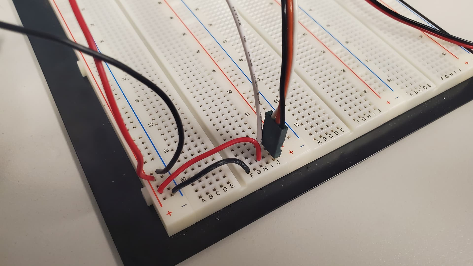

I wrote some test code to make a vex motor move using an Arduino. I wrote this code to try to get a better understand on how to make a vex motor work in Arduino. I uploaded to code to my Arduino but nothing happens I'm not sure what the issue might be, I think the code is good but I'm not sure. Also do I a battery or is the computer enough
here is my code
#include \<Servo.h\>
int MotorPin =4;
Servo motorControl;
pinMode(MotorPin, OUTPUT);
motorControl.attach(MotorPin);
digitalWrite(MotorPin, HIGH);
int motorControl(100);
delay(5000);

Please post an annotated schematic and links to technical information on the hardware devices. Frizzys do not work for me. You also need to follow the forum guidelines on posting your code. It also helps to comment the code.

Please edit your posts to add code tags.

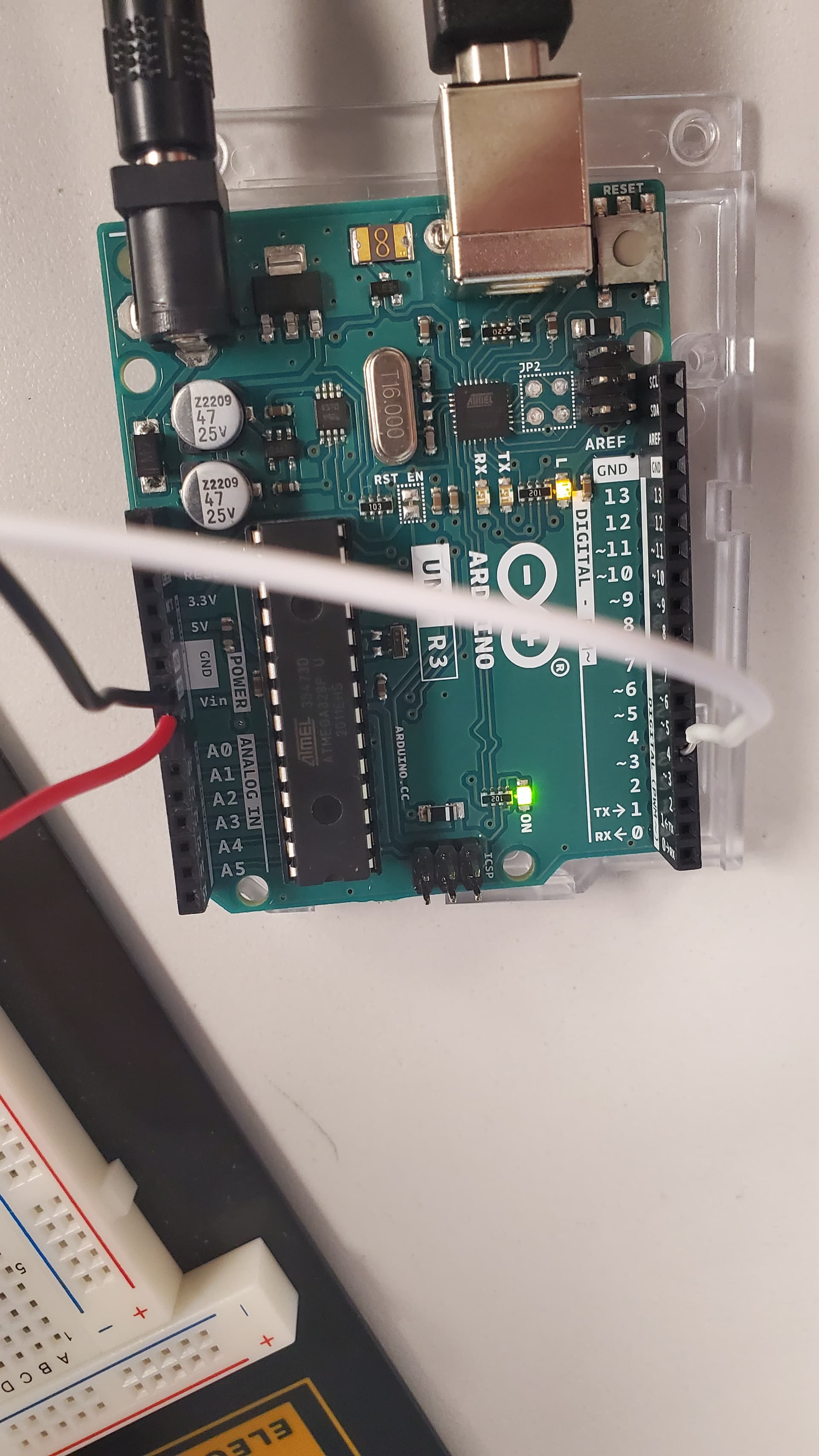

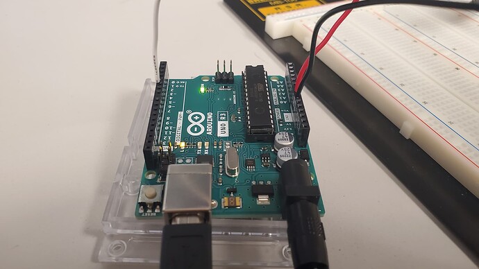

The Vex 393 is just a motor, and requires a motor controller, a separate motor power supply, and code that is appropriate for whatever motor controller you choose.
Do not try to use the Arduino 5V output to power motors or servos, and avoid any tutorials that suggest it is OK to do so (there are lots of them, and they are all wrong).

I plugged it into vin and I'm using an external power supply but it still wont run when I do upload.
Also what do you mean add code tags. Im not sure what that is..

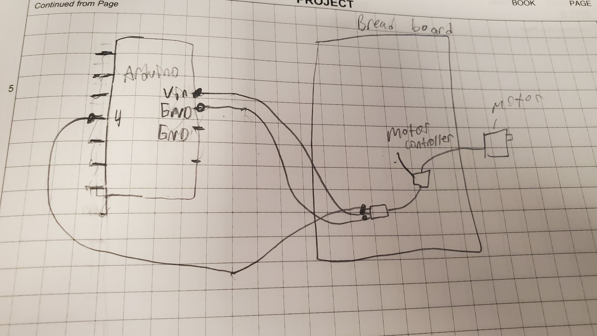

the vex motor I'm using has two pins but it goes into a motor controller which has three pins. The motor controller part is wired up to the Arduino. Does this change the code at all and is the vex motor considered as a motor or a servo in Arduino .

> [@jmathew213123](#):
It seems clear that a two wire motor (usual simple DC motor number of wires) is being controlled by something that uses 3 wires to the controlling microprocessor (usual number of wires for a servo).
So it's a servo from the code point of view.
Now you may have a servo that goes from 0 to 180 degrees as the servo pulse goes from 1 to 2 ms or…
… you may have a continuous rotation servo that goes CW if the pulses are shorter than 1.5 ms, faster the more so, and CCW if the pulses are longer than 1.5, again faster the more so.

can I just take a picture of the wiring and post it here
<div class="post-metadata">
**Author:** ![alto777](https://dub1.discourse-cdn.com/arduino/user_avatar/forum.arduino.cc/alto777/32/317385_2.png) [@alto777](https://forum.arduino.cc/u/alto777)\
**Post date:** [February 15, 2023, 5:09pm UTC](https://forum.arduino.cc/t/vex-motor-code-help-need/1088689/19 "2023-02-15T17:09:50Z")
</div>
You can, but a hand drawn schematic in addition would be the best.
Just draw all the parts and all the wires and make sure to show where power is being provided and by what.
If you've never drawn a schematic, google
electronic schematic basics
pick "images" and poke around a bit.
It's very simple and again, pencil and paper and your cellphone is all you need, and is often the best, as you need to know how to do it by hand if you ever get around to using CAD schematic drawing, as it will not think for you anyways. A distraction you don't need here.
a7

and here are the pics
 ![20230215_111924](https://europe1.discourse-cdn.com/arduino/original/4X/c/9/d/c9d79256bacc888e29d6ea83c38081135144e795.jpeg)
 ![20230215_111947](https://europe1.discourse-cdn.com/arduino/original/4X/2/5/3/2534f44b56ee74baf8e8382fc36115aac1df6e9c.jpeg)
 ![20230215_111934](https://europe1.discourse-cdn.com/arduino/original/4X/8/a/6/8a602d353b85c4bf427a17fbe8a6137ba14be9d0.jpeg))
 ![20230215_111918](https://europe1.discourse-cdn.com/arduino/original/4X/2/3/9/239fd06231f3029d0a6feb3d9067589ca689fc1c.jpeg)
