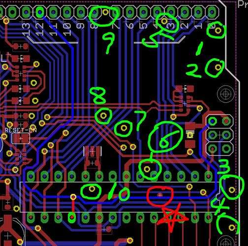

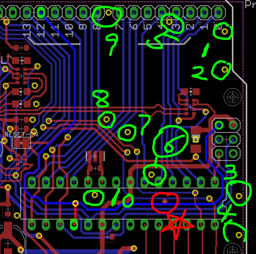

Here is another screeshot with more vias than I could understand. Could you guys help me learn the knowledge of how should we design them?
And there is a star with indicating one of the three "FD"s(FIDUCIALMOUNT), is that important?
Also, there is a small Circle on the right top corner of ICSP1, which is even hard to recognize; what does that do?
Thank you!

It indicates pin #1.
"Fiducial" is a mark on the final PCB that the assembly machine can see (with a camera) so that it can align the board while placing the components. It has no electrical purpose.

Any via on a board that isn't obviously associated with a trace will almost definitely fall into one of the two categories that have been explained above i.e. they're either for connecting the ground planes on the top and bottom of the board (this is called stitching) or else they're to provide an conduit for heat from a component to give a greater surface area (the bottom of the board) to dissipate heat.
Fiducials are markers on the board to allow a pick and place machine with a vision system to detect the position of the board and correct any alignment issues. See Fiducial tips edit - hadn't seen MorganS' post above beating me to that explaination

Definitely linking groundplanes so there's no parts of it flapping around at logic frequencies and
causing EMI. Any two layer board has to make compromises with its ground plane, since it will
have to swap sides a lot. 4 and 6 layer boards have at least one dedicated ground layer.
