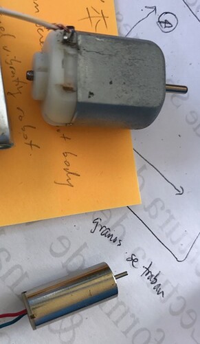

Ive tried making one out of a simple dc motor. I dont have access to one of those nice offset weights that you see here:
I've run into a couple of issues and I need advice.

You want a relatively slow spinning motor (this is why the hubsan motor wasn't going to
be a contender, they run at 50,000rpm or more). About 500--1000rpm is right. Something like
a 12V motor run at 3V might be good.
The vibrational forces go up as the square of motor speed and square of the mass-offset, and
usually impose a large load on a small motor (so watch out for overload/overheating)
OK I have a 12vdc. What about an offset weight, what can I use at the tip of the shaft?
