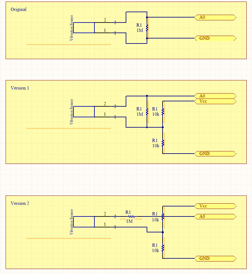

I'm pretty untaught of vibration measurement. my goal is to measure the natural vibration of a pc fan.
I have a piezo film sensor and the fan. I stuck the sensor on the fan so that the weight can swing freely.
parallel to the piezo I have a 1Mohm resistance. from there the "-" of the piezo goes to GND and the "+" to A0.
the program looks like this:

Unfortunately, I only get a very small value sporadically (1-10). Can I somehow increase the accuracy of the piezos? or is this simply not suitable for this measurement?
I am grateful for every help and every advice.
Piezo's are bipolar, you have to bias one end of the piezo to mid-rail voltage (ie 2.5v) and the other to
the analog pin.
Try increasing the 1M to a higher value for more sensitivity, this resistor is converting a current to a voltage,
so the higher the value the more voltage you'll get (upto some limit). Piezo elements are current sourcing,
not voltage sourcing, which is why the resistor is used.
First of thanks for the quick help.
because I was not sure how you meant it with the mid rail voltage. I've tried that as described in png.
but both circuits did not work as they should. in version 1 I had permanently about 2.5V. or is it intended that 2.5V then represents my new zero point? Then I would have to subtract only the offset in my program. or am I on the wrong track?
with version 2 I got no results which I could interpret meaningful somehow.
I increased the parallel resistance to 2M, which also brought an improvement, but only a very small one. I have just run out of resistance, I have now ordered a 4,7M, I hope it will arrive tomorrow, then I test it again.
