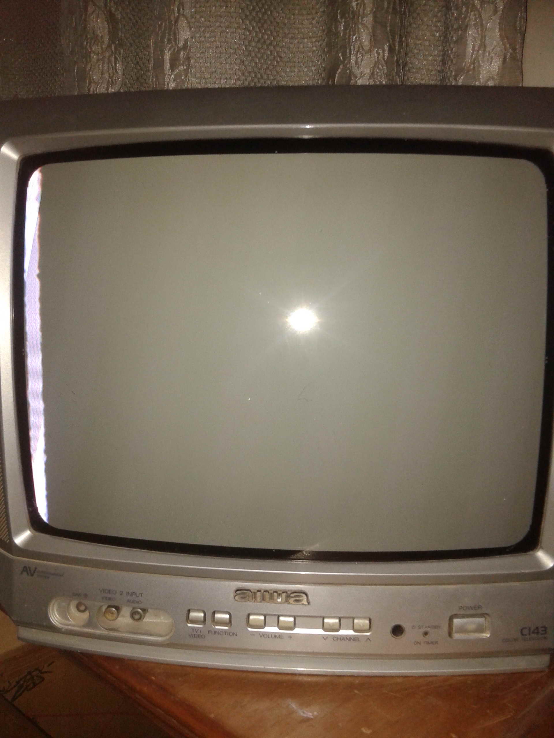

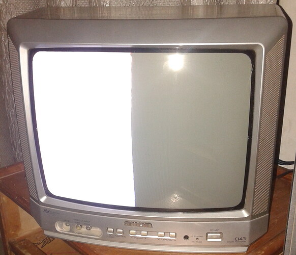

To make life easier, I divided the project into three parts, the first was to generate flat screen with two black edges and the horizontal lines in between may switch from black to white depending on set value of variable named (X), which went well (see attached pictures showing several levels of X), then the second part is to simulate the change of sat tuner base-band level using pot, then the third part to control the sat tuner using I2C .

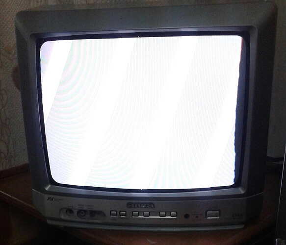

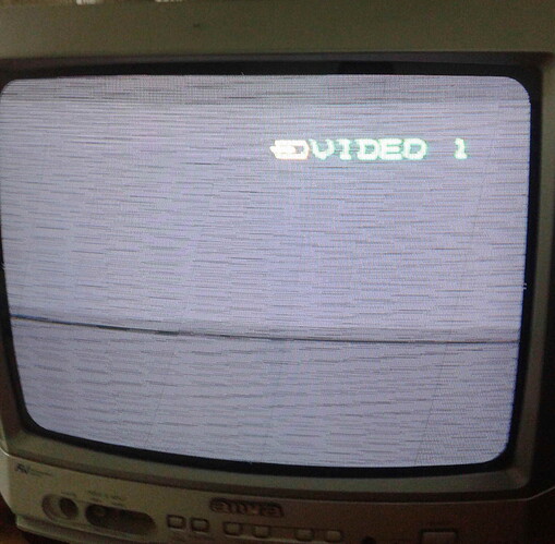

Next was to change the value of variable (X) using pot connected to PB2, the problem started here, when enable the code to set (X) from analogRead the sync will go crazy like been multiplied several times (picture attached), I searched a lot but so far I am unable to understand why sync is multiplied, if any of you guys have a clue please jump in, attached the INO file for reference (code seems to be too long to fit within 9000 characters limit for this message !).
Analogue read takes a long time to complete (see here) and is blocking so will screw with your core programs timings. It is possible to program the ADC hardware directly so it returns results quicker but you best option might be to set it into a different mode so you start an ADC reading and then continue with your code. When the ADC result is ready it can either generate an interrupt or you could poll the ADIF flag when convenient in your code loop.

The tiny85 does not directly support I2C but uses a Universal Serial Interface (USI). You may find using USI will also mess with your timings but maybe you could turn off the display output while using it (assuming short bursts of data).

firstly, I think you really need to be running your syncs from an interrupt
Secondly, are you using a crystal or the internal resonator ?
The internal resonator may not be able to create a stable enough frequency to create a good sync
I have done many projects involving TV PAL signals
just as a start, look here MADNESS: AtTiny13a VGA driver - 40*40 pixels in 8 colours - Displays - Arduino Forum
Personally, I would do all the video processing in an interrupt, possibly one for VSYNC and another for HSYNC & line rendering and do all your analog reads in main (outside the interrupt)
