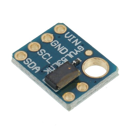

I can get VL53L0X to work with Adafrui and/or Pololu library (I will be talking about Pololu library).
I need accurate but not fast measurement (2 times a sec is plenty) – I enabled „HIGH_ACCURACY“ and set time budget to 0,5s, but then Arduino just waits till VL53L0X reports back distance and then continues, that's an issue because it needs to multiplex display and check other stuff.
I've done some digging and find out that VL53L0X can send interrupt when measurement done and data is ready, but as to my knowledge none of those above libraries have this feature.
Is there an easy way to do this?
Maybe it's possible to send "start measure" command to VL53L0X and don't wait, but rather send another command to get data after certain period of time?
Thanks in advance.
I'm using this sensor version:
