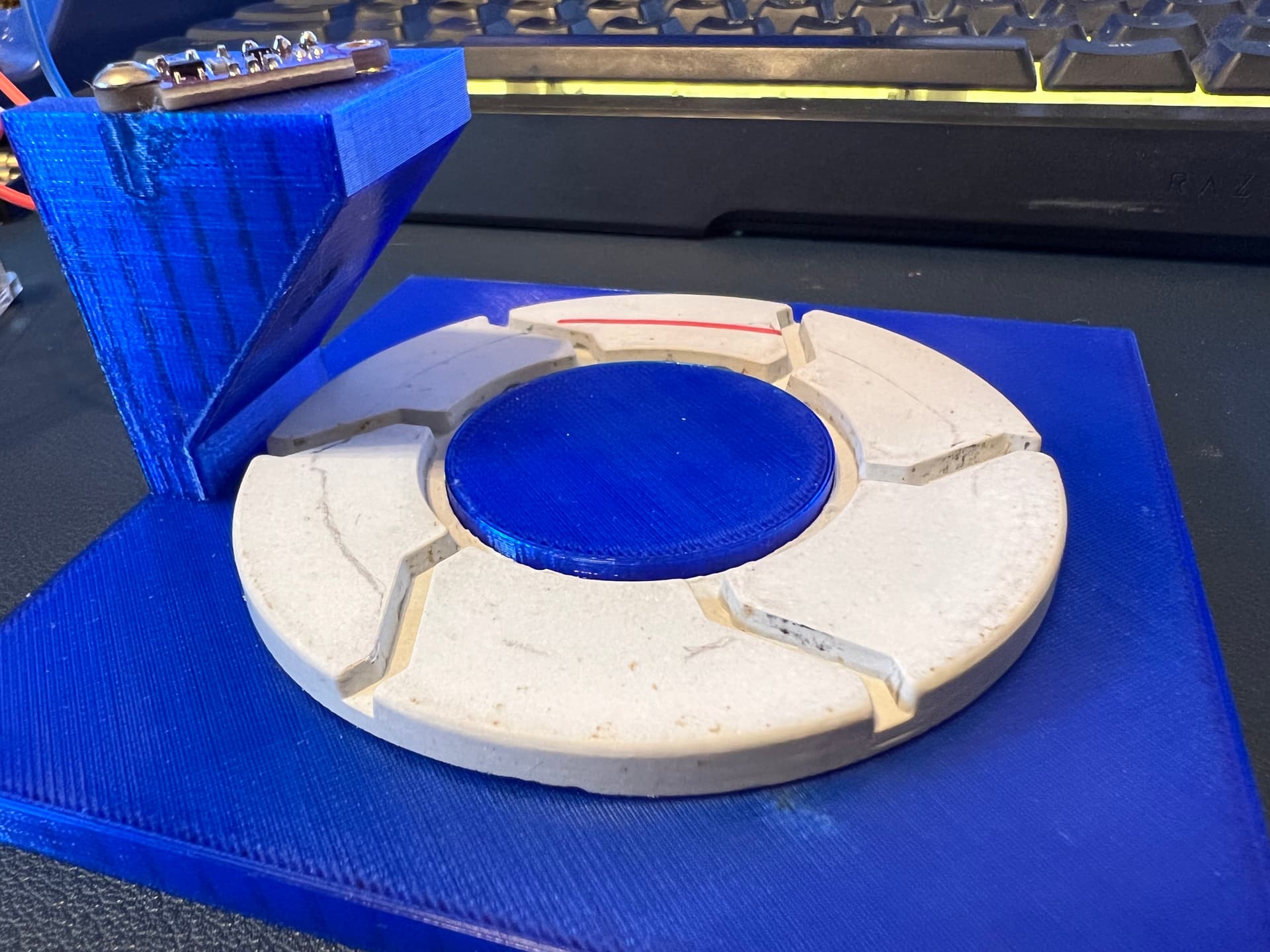

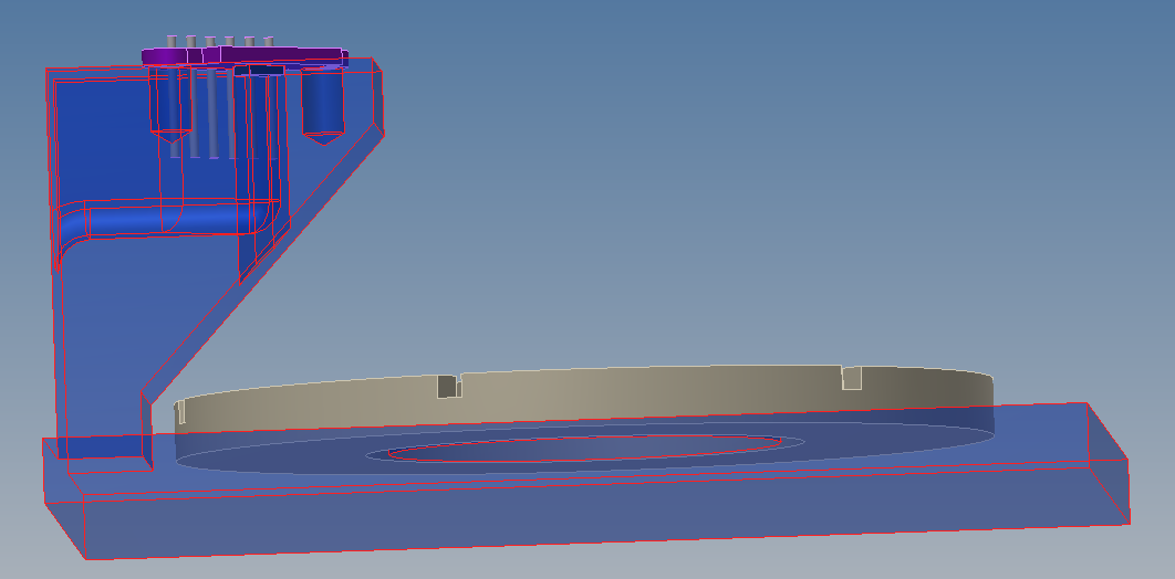

I am building a measuring machine for ceramic abrasive pads and I chose to use the VL530X board. I 3D printed a testing mount for the sensor with the face of the laser module aprox. 1.244"-1.334" (31mm-33mm ish) from the face of the ceramic disc depending on if its lined up with a groove or not. Its hooked up to an arduino mega and running the adafruit example code that just displays the distance in mm to serial port monitor. But it seams like the sensor isn't able to pick up the grove as I spin the abrasive pad under the sensor. In fact the with the disk stationary the distance values are jumping up and down between 38-41mm, which isn't even close the intended distance of 31-33mm, though this could be do to inaccuracy of the 3d print. That aside is the VL53L0X not capable of this? I know I'm asking a lot of this board and wanting it to perform at reasonably tight tolerances given the boards specs. But I thought I could find a work around knowing that the grooves are evenly spaced and taking multiple measurements around the disk. I even aligned the sensor at the same angle as the groves to maximize the surface area of the grove it is measuring.
Should I be using something else?
or is the 3d print possibly messing with the readings cause the laser is shooting down a tight channel?
also why is the measurements so jumpy? I thought it might jump hear or there but with a stationary disk but I thought it would at least be somewhat consistent in the distance measurement even if it was off by a mm or two.
In the end the measuring machine will be filled with 30-50 abrasive disks where they will be pushed out one by one and then rotated using a geared motor with encoder, then as it spins it needs to find the location of the grooves so it can spin the disks to locate the large pads under an electronic dial indicator where it will take thickness measurements and using a data cable and excel figure out if the disk is in tolerance then repeat.
Bellow I'll attach pictures of my testing setup as well as screen shots of the 3d model so you can see how I printed the fixture.

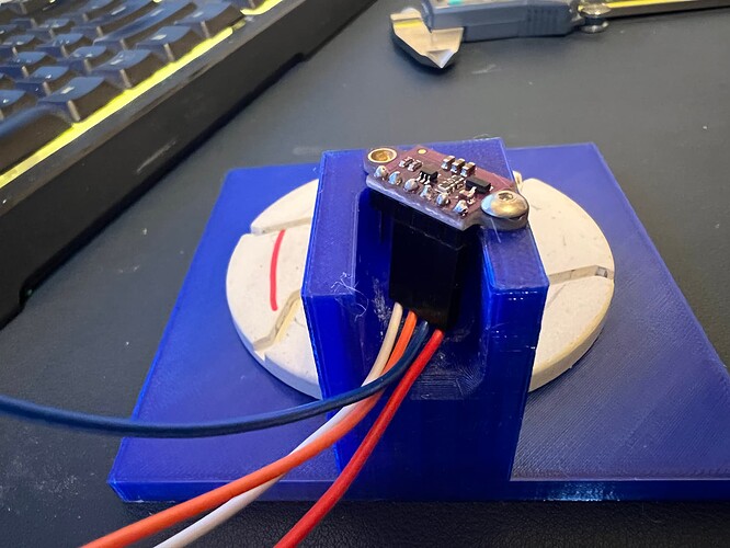

I've not used the VL530X, however I noticed the opening for the beam is on the small side. I would hang the sensor off the edge of the pedestal with plenty of clearance and retest.
i gave that a try and it still seems to jump all over. Though the distance hasn't changed now its reading between 43-47mm. I don't see why the the distance range wouldn't be the same?
do shadows play a role? I even increased the time in between measurements to make sure I'm not fooling myself with too many numbers scrolling by, but the same thing occurs. Though the sensor can read the slightest shift in angle. just seems to be a little weird to me. I must be doing something wrong, cause ive tried multiple different surfaces and still get a 4-6mm swing in readings which is quite large.
I wonder if there is an optimal distance it should be mounted at, as if its calibrated or something. but i would assume closer is better to a point.

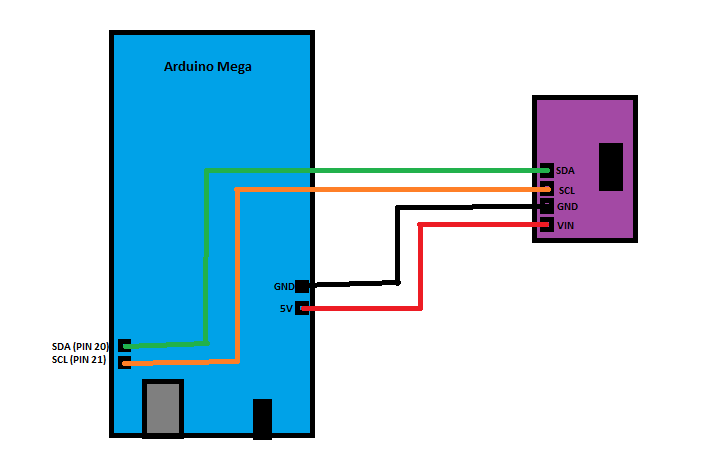

Can you please post a circuit diagram?

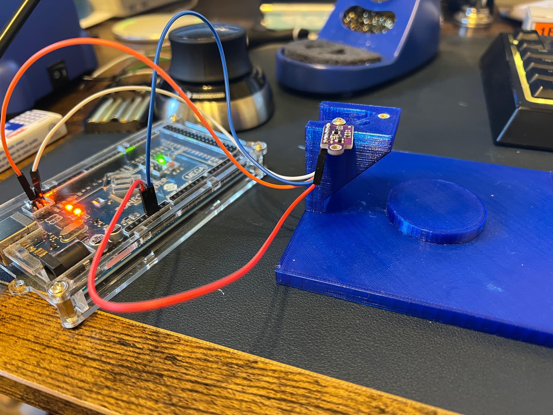

How are you powering your project?
Thanks for the clear pictures.

All of this testing was done with the board mounted off the side of the stand so that the small channel wouldn't play a roll in the readings. I'll take a photo of how its currently set up as well as post code and diagrams.
I have add the code as well as a "diagram" to the main post.
Sorry for the poor diagram, I had to do it in paint as I'm working on an old work computer and can't be downloading things to it randomly.

Here is a photo of how the sensor is currently mounted to ensure it is rigid and not moving while making sure the narrow channel isn't playing a role in the deviation of the reading.
The arduino is running of power it is getting from my computer via the usb
