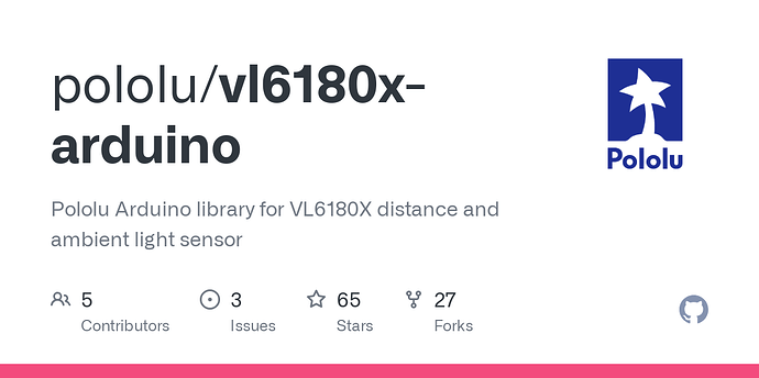

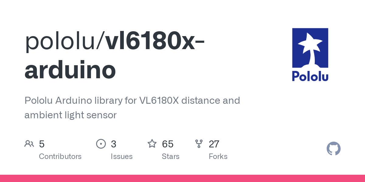

Did you try with another library?
Like this:
for the VL6180X I used the Pololu library referenced by @kmin in post 4
running the InterleavedContinuous example code I get results
5cm	54
5cm	52
5cm	53
10cm	102
10cm	101
10cm	103
15cm	150
15cm	149
15cm	152
number on left is distance to target measured by a ruler number on right is the VL6180X output
