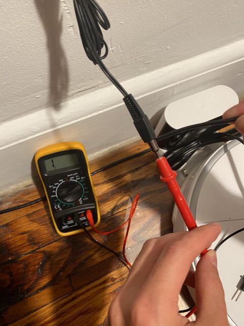

The problem is when I hook up my ESP8266, it doesn't power on, and I see the voltage drop from 12V to 1.4V. I don't understand what causes it.
The buzzer's power supply shows 12V with 1.4 Amps which should be more than enough for the ESP8266 to power on.

As you can see, it reports roughly 11.3V with 1.4Amps:
And here, when I connect my ESP8266, the voltage drops to 1.5V:
Nothing too fancy here, just hook up VIN pin to + and GND pin to - on the intercom.
The amperage stays the same (I am not sure if it matters, not very good electrical engineer):

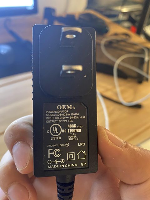

I found a power supply with roughly the same parameters: 12V with 1Amp
And when I attach my ESP8266, it works like a charm:
Just to check but when you measure current on a meter you do not wire it up like when you measure voltage.
To measure the current you must break the circuit you are trying to measure and put the meter into the break. The meter then acts like the piece of missing wire to compleat the circuit. It looks like you were not doing that from your photograph. Also most digital meters require you to use a different socket on the front of the meter than you use when measuring voltage.

You are not measuring current correctly (already pointed out). Further, your meter appears from the pictures to be on a 2mA (two milliamperes) scale. If it is 1.5mA and 12volts, there is a resistor (not far away from 10k) between the measuring points and the power supply.
