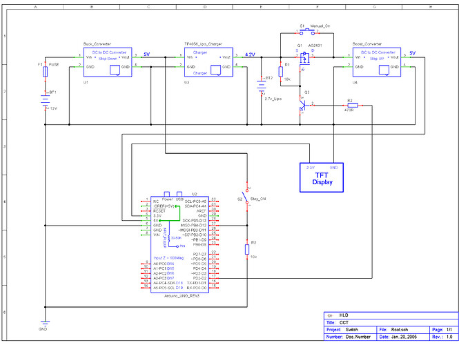

I wanted to ask, will the above circuit work at 3.7-4.2v? And is it a problem that the gate voltage is higher (5v)?
What is your battery voltage ?
"I wanted to ask, will the above circuit work at 3.7-4.2v? And is it a problem that the gate voltage is higher (5v)?"
What kind of Arduino are we talking about, 3.3V or 5V ?
If you are saying the voltage output from the Arduino is in the range of 3.7-4.2v this is confusing as 5V Arduino will have 5V on a digital output and its 5V pin will be 5V.

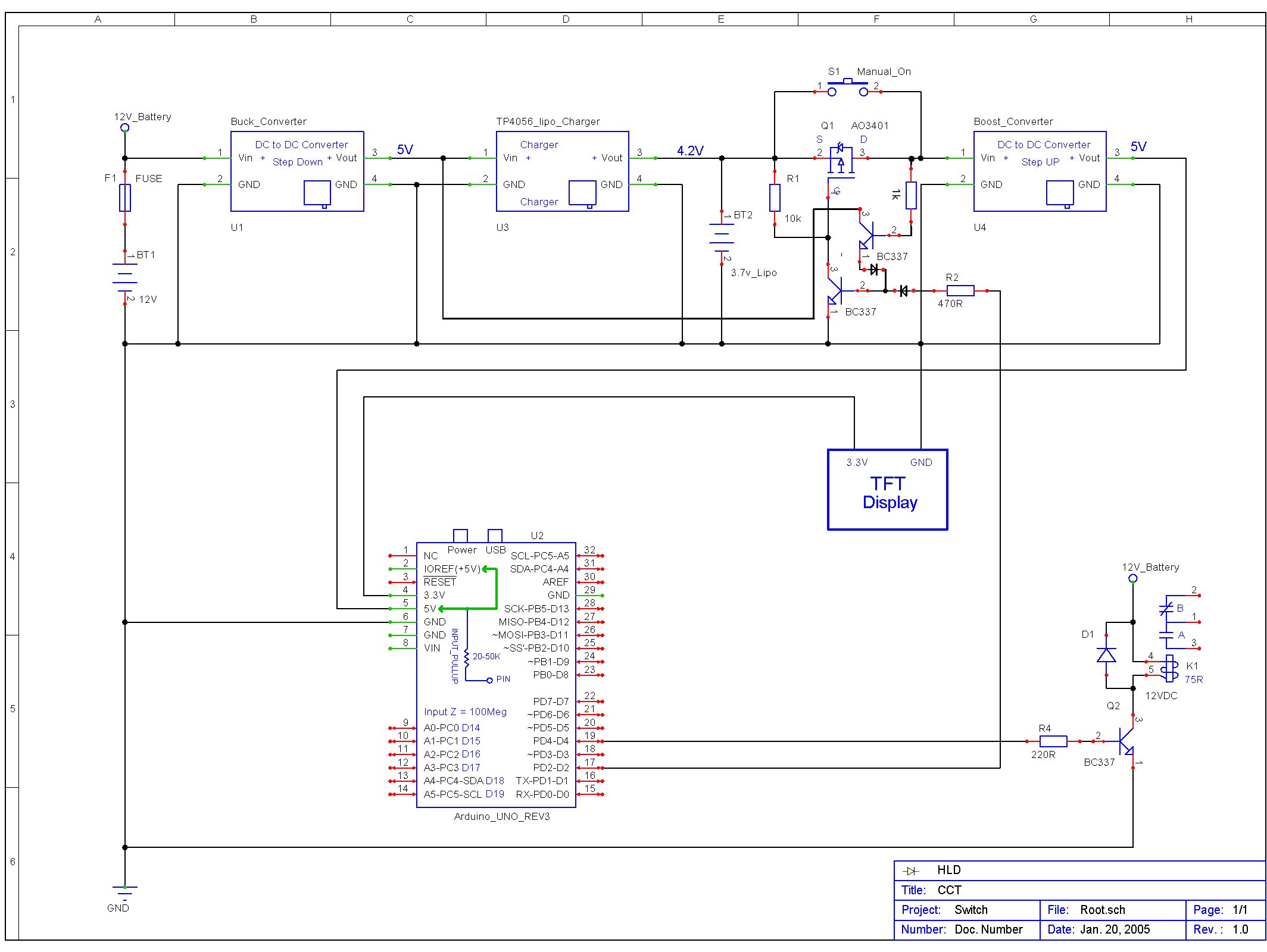

Note you can use an NPN transistor to control the series pass P channel MOSFET.
See attached schematic.
If your battery is 12V then you do not need a "logic level" P channel MOSFET so that will make your hunt easier.

The circuits so far discussed will not power up by them selves.
Sorry, I mentioned above how I have things set up, but it was a long post maybe you missed it.
I have an Uno, and I have it set up as follows:
12v -> buck (5v out) -> TP4056 lipo Charger (4.2v out) -> 3.7v Lipo -> latch circuit -> dc-dc step up (5v out) -> Uno
I want the latch to be between the lipo and the step up. The gate voltage will be 5v from the Arduino, and there will be approx 400mA @ 3.7-4.2v running through the latch.
Will this be a problem, and will the components work?
Also not sure if it’s worth mentioning, but the display runs on 3.3v from the 3v out of the Uno
I will power up the device via a push button, and it will turn itself off after x amount of time.
A digital pin will be connected to the buck converter, if this pin is high, the Arduino will not start the power off timer.

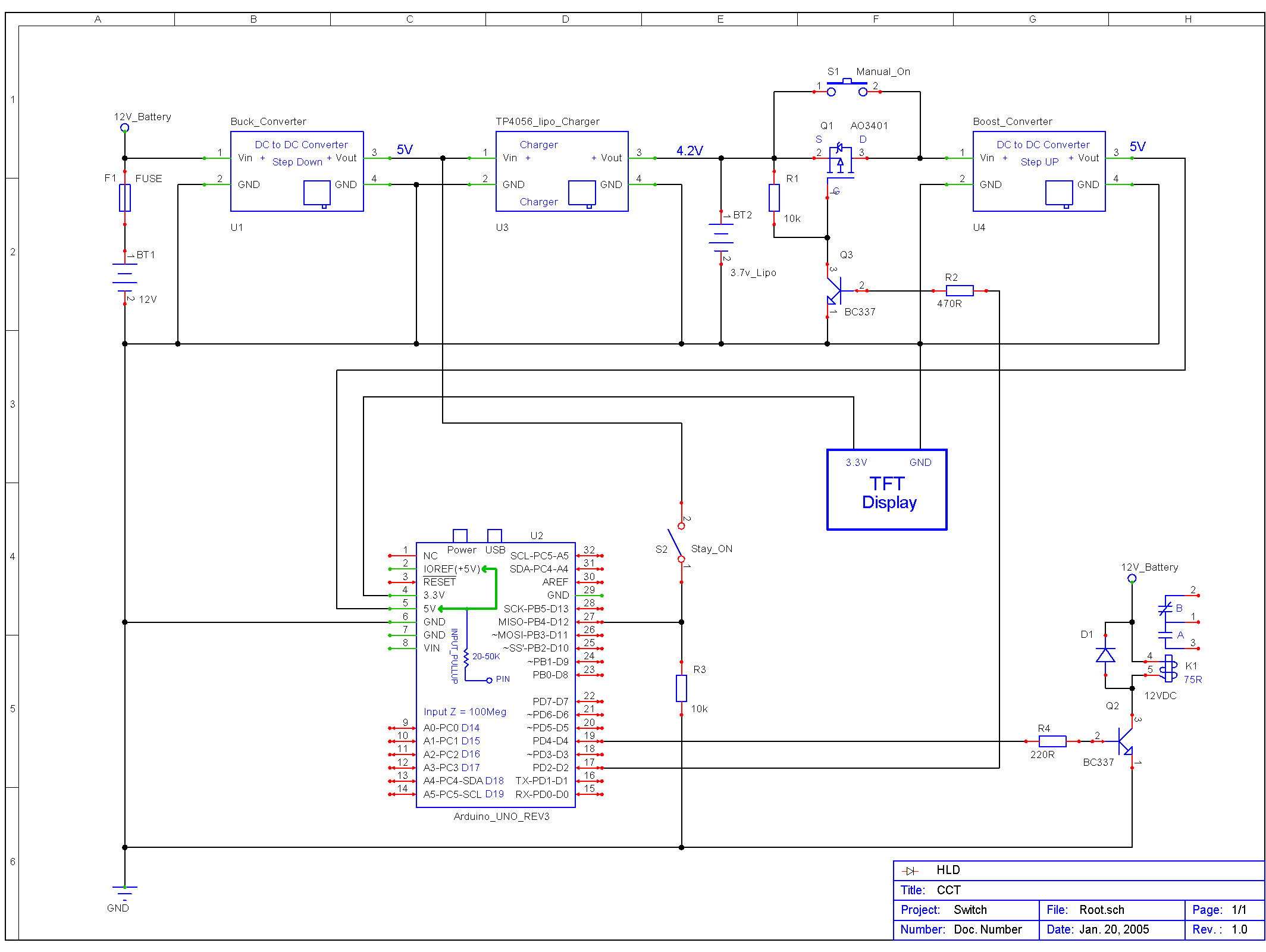

I still have some BC337’s laying around, will this be suitable to drive the MOSFET?
I am also driving a 12v relay from the Arduino, at the moment I am using a BC337 with a 10k base resistor (coil impedance is 75 ohms). Should I also switch this to a MOSFET? If so, will the AO3401 also work, or do I need an N channel? And can I switch it directly from a digital pin?

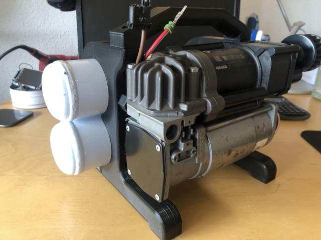

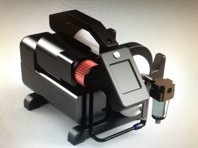

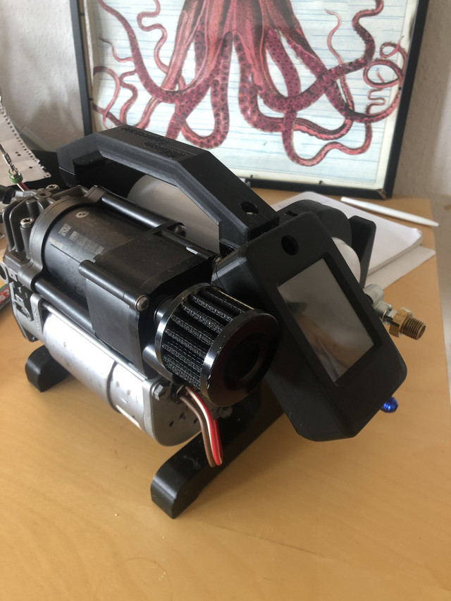

Here are some pics of my project, it’s a small mobile compressor for track days :slight_smile:

The BC337 would be okay to use to drive the P channel MOSFET in the schematic offered.
Ic = 12V(relay voltage) / 75R(coil) = 160mA for the collector current.
For Ic = 160mA, suggest you have 20mA base current therefore R(base) = (5 - .7) / .02 = 215R use 180R or 220R for the base resistor.
A digital output will drive your BC337.
Make sure you have a kickback diode across the relay coil.
Any DC motors should also have noise suppression.

I would like to make the plans for the compressor available online once everything is finished, would you mind If I use your diagram for this purpose?
Use as you wish.

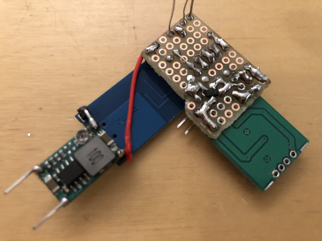

The parts arrived today and I assembled everything, and the Latch works very well. I changed the design a bit to include two diodes so that the buck converter turns on the device via the transistor instead of connecting it to a digital pin and doing it in software.

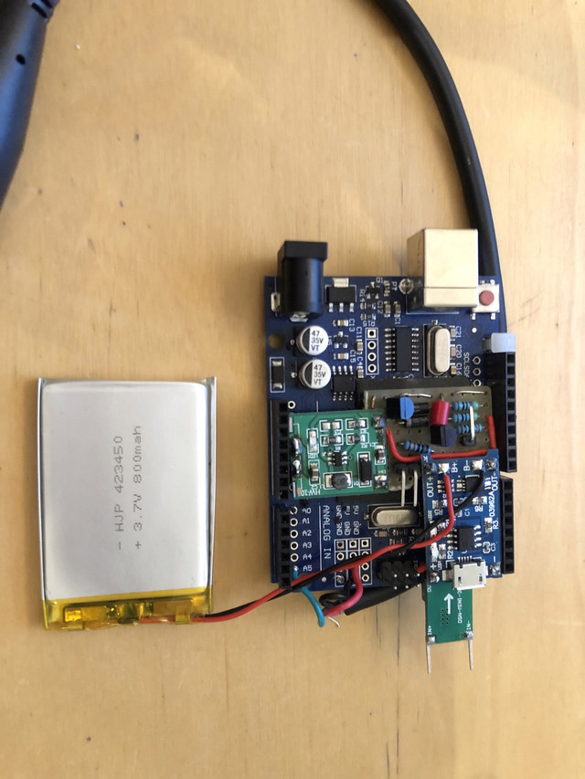

I was however mistaken when I said I had some BC337s left over. I had actually used them all on previous iterations of the latch circuit, and what I had in the parts box were actually 2N2222A transistors.
I double checked the specs from the suppliers and the hfe was basically the same (250 for the BC337 and 100-300 for the 2n2222a), so I used them instead. The latch works fine, but the relay driver doesnt work at all.
I had actually bought the 2n2222As specifically for the relay driver shown here: but it didnt work last time either. I am a bit stumped, I thought maybe last time the resistor was too big, but this time I used a 220 Ohm resistor and it still doesnt work.
A 2N2222 should work fine.
Double check your transistor pinout.
Confirm with a DVM that the 220 Ω is indeed 220 ohm.
Check that your relay is 75 ohm and it will ‘pick’ if you connect it to 12v with alligator clips.
I can confirm the relay is 75 ohm, I have measured it. Manufacturer specs say 1.8w, which fits (I think it works out to be 80 something ohms in theory, pretty close). I will double check that it is working by powering it directly. I had 2 new ones, on this particular one I popped the cover off and installed the diode inside, maybe I messed it up. I did measure again afterwards though to be sure there was still continuity through the coil.
Transistor part number is CTPN2222A LS. I am pretty sure this type has the emitter on pin 1, but I couldn’t find a data sheet matching this exact part number.
Also the latch works so I guess the pinout must be correct?
The resistor definitely came from the 220R packet, but I didn’t physically check the resistance or even check the band colors. I will double check that too.

Try the lead configuration C B E rather than E B C
I tested it out, didnt work...
Turns out it was just a dud transistor. I removed it, tried a new one backwards, didnt work, so I reinstalled the new one in the original position and it works now.

I would like to have the latch remain off unless the button is pressed. I have to do it externally because I cant fit any more code on the UNO. I'm at 99% and the if statement to only start the timer if another pin is high puts me a few bytes over.
The reason I want to do this is because when finished the only way to charge the lipo will be via 12v, and the lipo will never charge fully if the charger is also powering the uno at all times when connected to 12v.

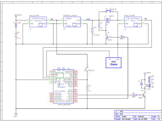

Therefore I have come up with the following plan.
Goal: The latch remains on if
  1. the button has been pushed and
  2. the buck is powered by 12v
![](http://<a href=)
Will this work?
More importantly, is it the correct way to tackle this problem, or is there a better way?
Then what is the purpose of the Lipo ?
Your circuit modification will wipe out the transistors.
The lipo is there to power the device when not connected to 12v.
The aim is for it to work as follows:
  • If 12v is not connected, I push the button, the device powers up for 20 seconds to show on the display how much pressure is in the system, then switches off automatically.
  • If connected to 12v and the button has not been pressed, the lipo will charge, but the Arduino/display are off. (This allows the lipo to be charged without load from the Arduino and display)
  • If connected to 12v and the button has been pressed, the device remains turned on until 12v is disconnected.
As I mentioned earlier I had planned to just use the output of the buck as a signal to tell the Arduino to not begin the auto shutdown timer.
Unfortunately I don’t have enough memory for that, I am already on the limit due to display drivers and widgets. I have optimized the sketch as much as possible, and I am even using a modified version of the GUISlice library to reduce memory, but I can’t get enough free space to implement the if statement needed, it puts me about 50 bytes over max. The UNO is completely tapped out.
Do you think it’s possible to meet these criteria? Or do you think I could just leave it how it is, that the battery is charging and the Arduino is powered up both simultaneously whenever connected to 12v?
I measured last time the step up draws about 400mA. The lipo is 800mA. And the charger should output 1000mA. Will this be a Problem if I don’t have some way to disconnect the Arduino when charging?
Another Idea I had was to add an NPN transistor in parallel, and trigger it from the buck. Would this be a better solution?
