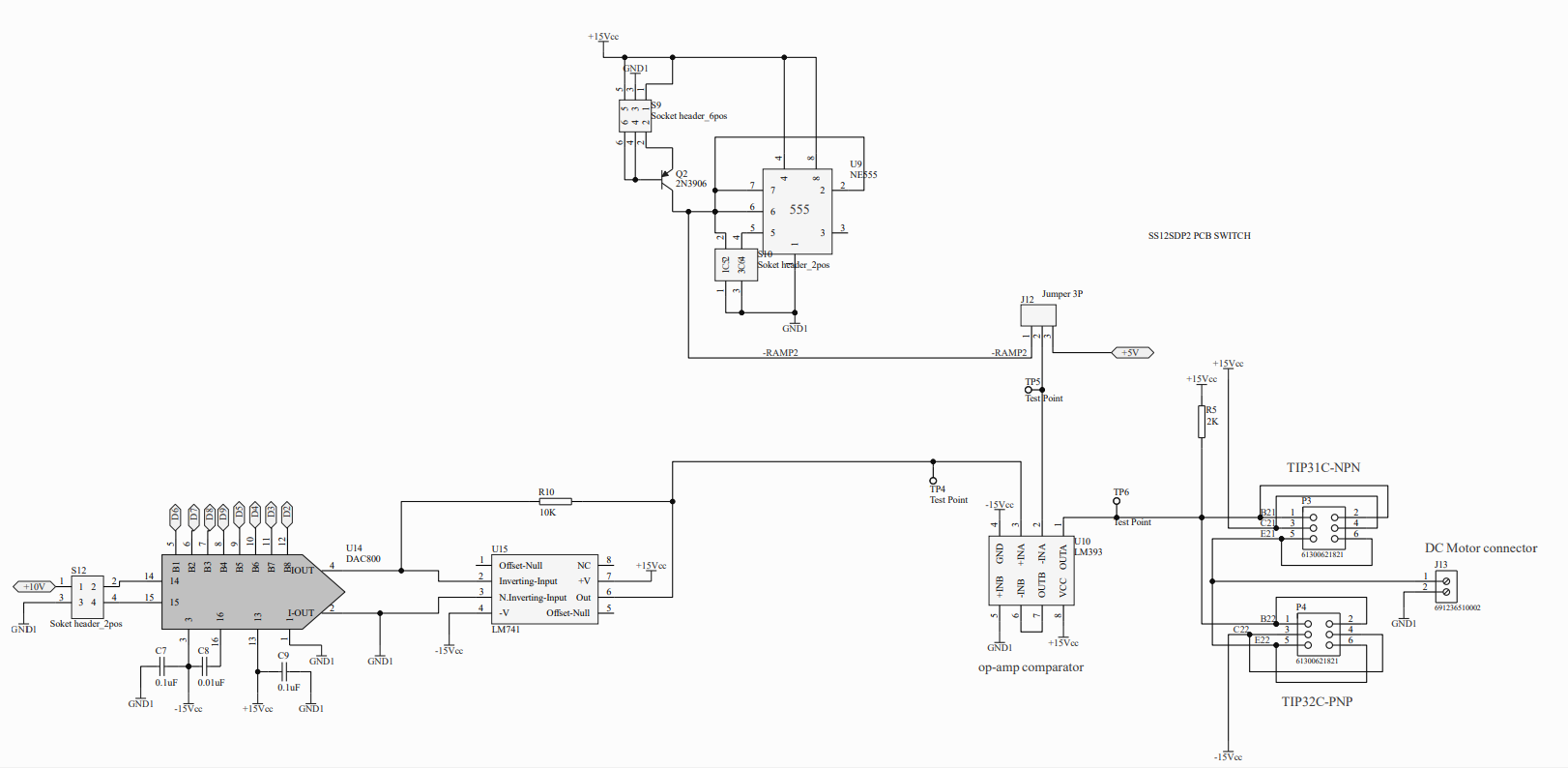

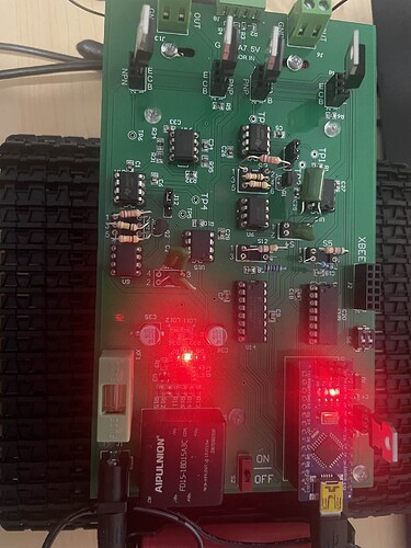

Voltage Isnt being powered through Arduino car
e
Hello, ive recently got an arduino car that I previously was able to get voltage through on a breadboard, but when transferring it to the final car it doesnt seem to be powering to anything even when power is turned on. I am wondering if theres something wrong in the code or if its a hardware problem as I am currently trying to power a motor but cannot power it at all through the circuit now
Hardware per motor:
Dac0800
2N3906 PNP
TIP32 and TIP 31 PNP andNPN
LM393 comparator
LM741 Op Amp
NE555 timer
33GB-520-18.7 DC Geared Motor
Arduino Nano
This is the code im trying to test if it works

Also forgot to provide a schematic / circuit diagram for us to review alongside the code.

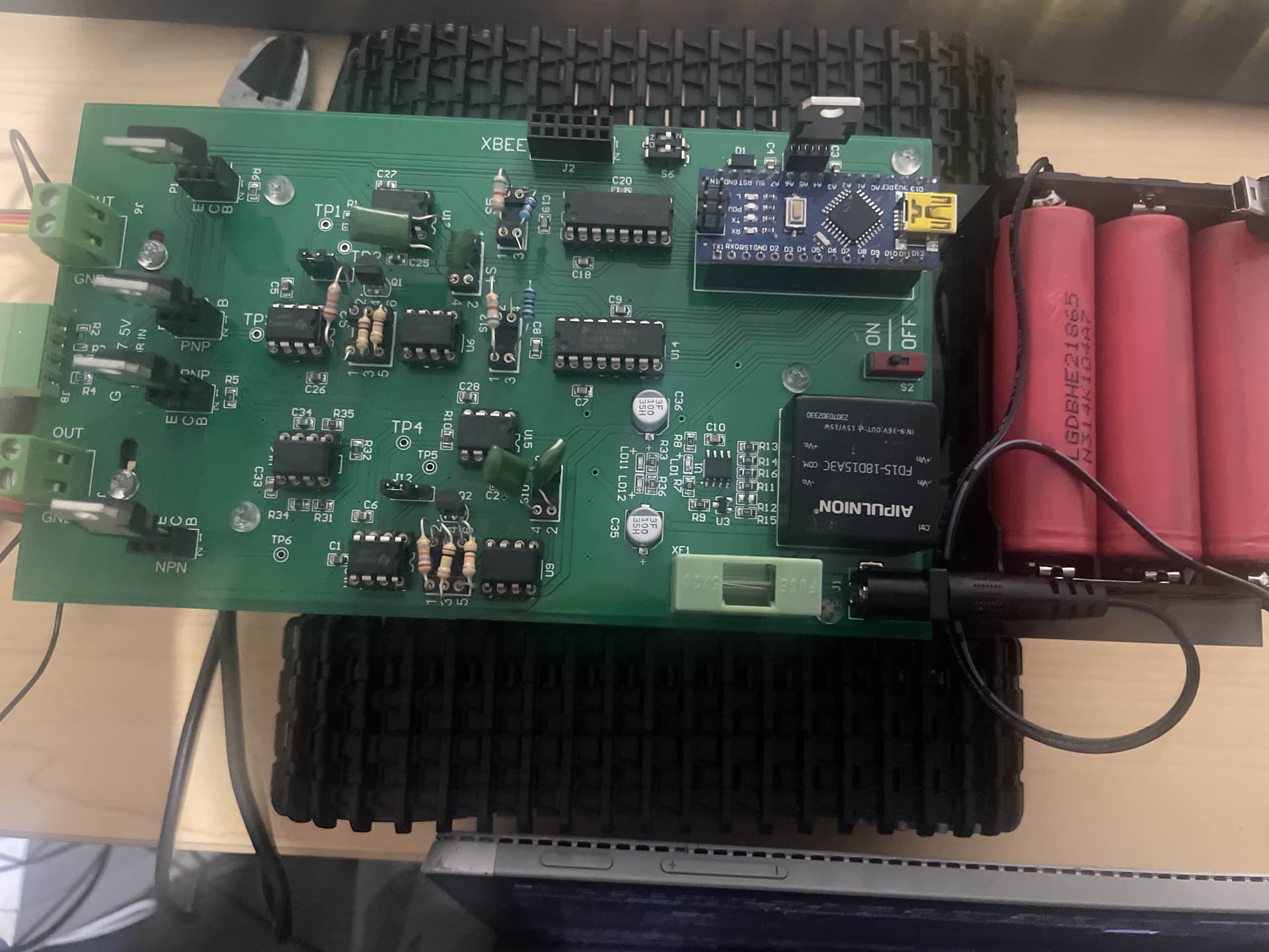

Can we have a picture of the backside of the soldered print?
I would start looking for bad solder joints.
Also the sockets with resistors may have loose contacts.
You might want to shorten the legs of some components. The may get bent and cause unwanted contacts with neighbours...

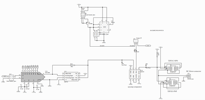

These are the schematics used for each motor (Ignore rx and tx)

I dont know if its relevant either, but when running the code, ive sent up an LED reading for case output1 which is what im trying to transfer the voltage through whenever I press the output1 button from C# to the Arduino , and it transfers to blink the LED light as coded
It’s a bits n pieces schematic, almost useless for diagnostics.
I’ve never seen a 6-pin TIP transistor, and nothing suggests the operational role of each component in two different blocks.
No power supply blocks that I can see… ?
Well ive checked for power and its only going up to the input of D1 and not outputting to C4 on the PCB layout, so its not transferring through to U5.
I was going to shorten them like you said, i just wanted to make sure power is somewhat flowing
Transistor is 3pin, as shown in the schematic only one row has to be used since the other 3 are connected to it
Power supply is the three lithium batteries in the first image, 3.6V each
This is for one motor which im currently trying to run, its connected to two motors with the same layout but under different PCB values.
Im confused to what you mean as well in regards to nothing suggesting operational role of each component in two different blocks
Where can we find D1 C4 U5?
on the pcb layout i sent in the first post top right
And how does the board relate to the schematic?
Hint: the schematic should represent what is on the board...
Usually, one can look at a schematic, follow the lines and components, and get a pretty good idea of how it’s intended to work. That’s all.
There are standard styles that help communicate those ideals.
