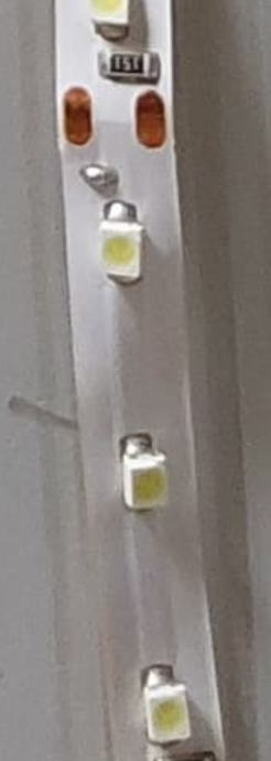

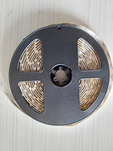

Hi! I have a LED strip that I ordered a long time back and i don't remember the voltage of that strip. I have attached the pictures of the LED strip below. Can someone please help me to find the exact voltage of that LED strip?

Try connecting it to 5V, if it lights then it's 5V, if it doesn't then it's probably 12V.

This appears to be single color LED strip, 1 current limiting resistor and 3 LED's in series. I suspect a 12v strip, (3 LED's in series drops the voltage down about 4.5v already) but if you can tell me what the value is of the current limiting resistor i can be fairly sure. You can use a multimeter to measure it, and by what is written on it.
"151" - 150 Ohms according to the image above.
20 mA if the LEDs drop 3 V each.

3v Each might be a bit much. (i couldn't tell from the image what the resistance was) but i guess to start with 9v, and measure the voltage drop to confirm.
3 V is pretty standard for a white LED, and that's why I gave you the zoomed view. :grin:
by the appearance the LED of the strip is the SMD5730.
It is for 3V and supports a maximum current of 150 mA.
But the 150 Ohm resistor, limits the current (if used at 12V) in
80mA, (12/150 = 0.080).
If we consider that each LED is for 3V, we will have 12V - (3V * 3) = 3V.
3V/120OHms = 0.020A = 20mA.
3V/150OHms = 0.020A = 20mA.
Each segment of 3 LEDs will consume 20 mA.

As per #7, except that it is 150 Ohms in the calculation, not 120. :grin:
