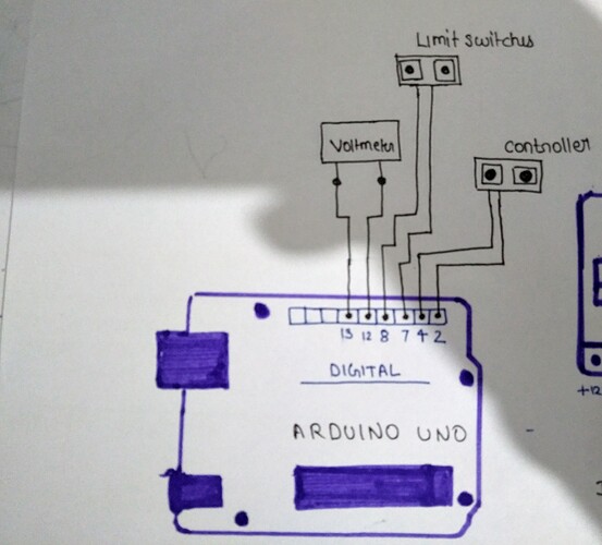

here are schematics
Doesn’t pin13 have an LED?
it have but just ignore it i have tried other digital pins but they are also doing the same
i saw your diagram
you can check voltage with respect to ground each pin 12 and 13.

Please answer my question! Did you check 5V power, and also where are you measuring the voltage? Is the "voltmeter" in your diagram displaying the 1.30V, or are you seeing it somewhere else.
It is extremely difficult to remotely troubleshoot something like this. Please respond and be detailed with answers to questions you are asked.
What happens when you disconnect the voltmeter, limit switches and controller? So that the Arduino is running stand alone.
Write a program to ONLY set a pin high and nothing else. What does your meter indicate is the voltage on that pin?

yes 1 the 1.3 v is the value shown by voltmeter connected to arduino pin 12 and 13 as shown in diagram
please ignore my stupidness while a am replying because i dont know anything about this forum how to use it
So if you’re checking with one probe on 12 and one on 13 you are checking for differential voltage, again there’s an led on 13 and the difference may be VCC-led diode fwd voltage. This is assuming they are both high. Why not measure with reference to ground?

//This program is working correctly
//This means that the problem is in code not in hardware
//Please anyone review my program and correct it

Here for completeness is OP's code fixed for:
  • else if rather than if
  • input_pullup rather than input, look for lows on inputs (buttons re-wired ofc)

NEW PROBLEM IN CODE
arightkerfuffle:
Because the pullup resistors will keep them high while not pressed; it's sop.
Can't read this...
Rather quote the message as text.
code problem is fixed
but with your new code pin 13 is constantly high

Oh yeah in my code I changed to pins 11 and 12 just incase the led and resistor on pin 13 where a contributing factor...
You should probably also consider and'ing your buttons to make sure the combinations are all properly covered, for example:
if (button2==LOW && button1==HIGH && blah blah){
ok thank you very much for your lovely support
going to try your code
