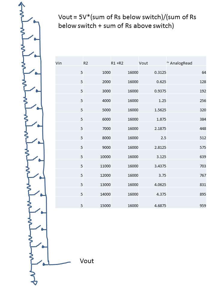

My question is what is the range (granularity?) I can safely detect? That is, if the voltage range to an analog pin if 0-5V, and I want 15 button, can I safely have no active keypress by 0-0.5V, key 1 to be 0.6 - 0.9, key 2 to be 1.0-1.3, etc.... Or is a range of 0.3 unreliable? (Would I need to divide up the button into 2 sections, using 2 analog pins?)

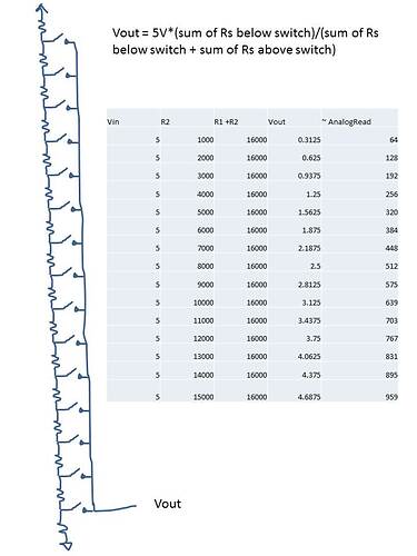

A string of 15 1K resistors should work pretty well, adjust the analog read break points to match:
Vout = 5v*1000/(1000+14000) = 0.3125V
Vout = 5V * 2000/(2000+13000) = 0.667
Vout = 5V * 3000/(3000+12000) = 1V
Vout = 5V * 4000/(4000+11000) = 1.33V
etc.
val = analogRead(Ax);
if ( (val >=0) && (val <=67){
// button 0
if ( (val >=68) && (val <=135){
// button 1
if ( (val >=136) && (val <=203){
// button 2
// etc
