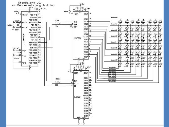

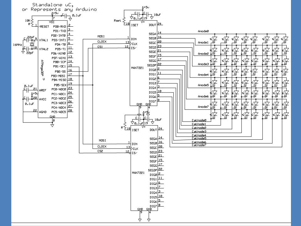

Check the Parola library, makes writing things to MAX7219/display easy.
Wiring up a MAX7219/8x8 matrix is pretty straightforward.
(ignore the 2nd Max7219 here)
