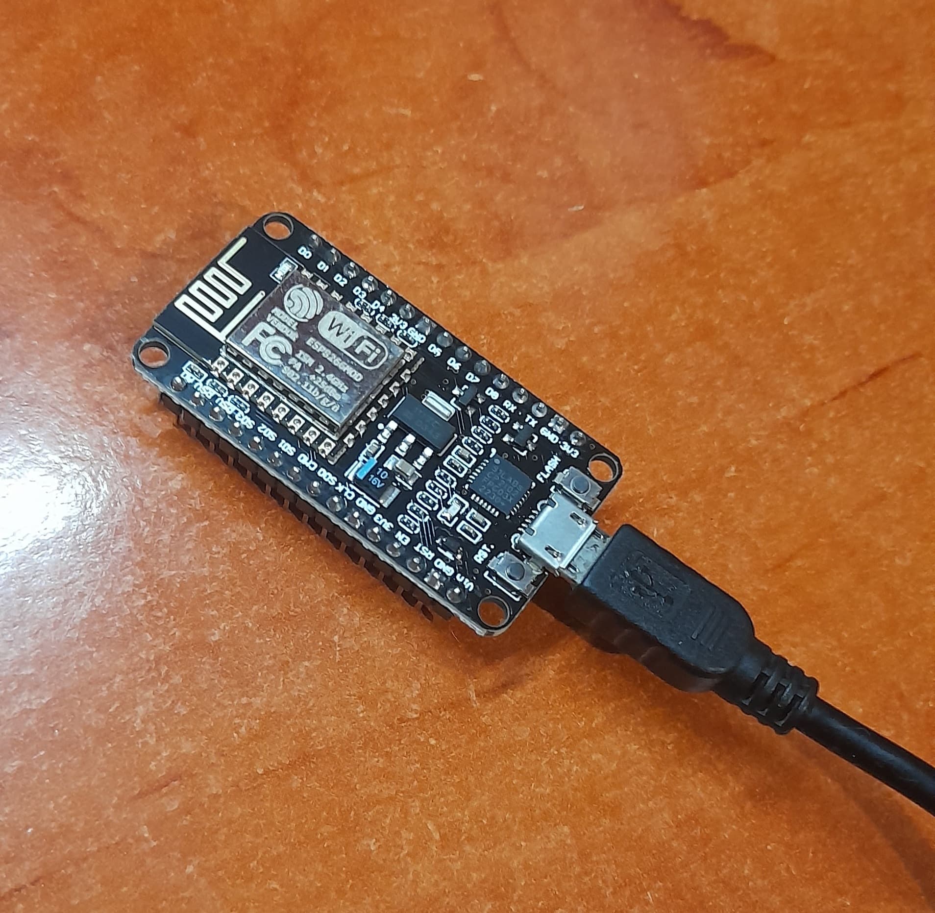

Hello there! I am new to Arduino and I recently bought an ESP8266 12E Development Board to try to connect to WIFI and try some stuff out. I have connected my esp8266 to my PC using a usb cable. I tried running the following code:

The console shows: "WARNING: Detected crystal freq 13.54MHz is quite different to normalized freq 26MHz. Unsupported crystal in use?" and also none of the print statements work, I see some boxes on the console.

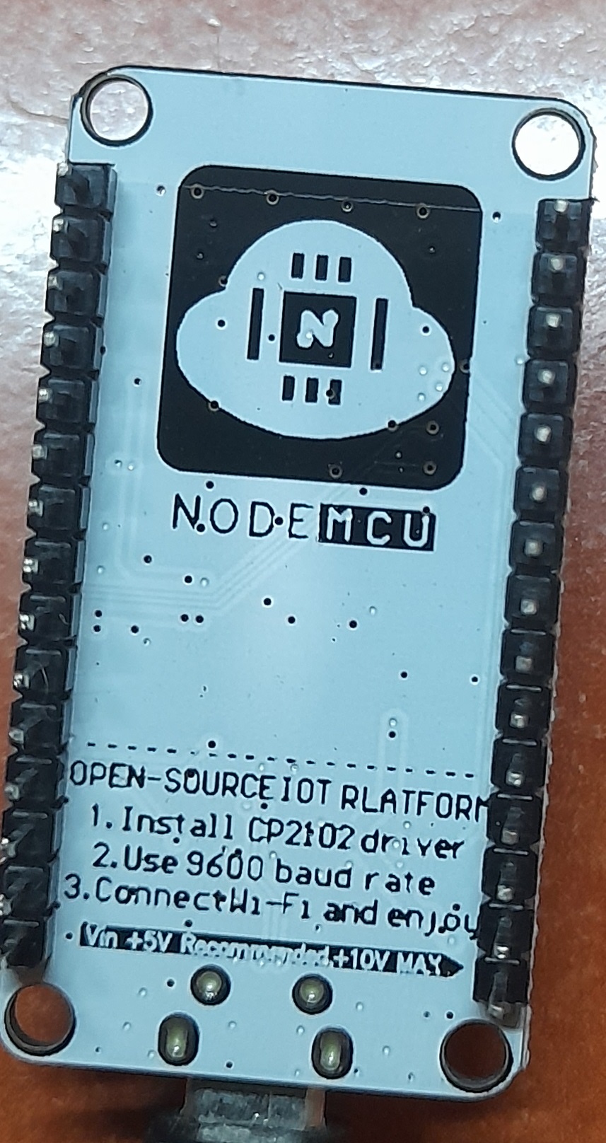

Note: I have installed the "CP2102" driver it says on the other side of the ESP to install and it also mentions to use baud rate 9600
Hi @lampropoulos.
Check to make sure "9600" is selected in the menu at the top right corner of the Serial Monitor panel. If not, select the correct baud rate and press the reset button on the board to restart the sketch program. Hopefully you will then see the expected "Wait for WiFi..." output in Serial Monitor.
Note that it is normal to see some boxes or other junk characters in Serial Monitor when the program starts running on an ESP8266 board. The reason is that the ROM bootloader on the ESP8266 microcontroller prints some debug output at 74880 baud, which becomes garbage output when you have Serial Monitor configured at another baud rate. But this is not a real problem because the bootloader's debug output is only useful for troubleshooting specific problems. So during normal operation it is correct to configure Serial Monitor for whatever baud rate the sketch is configured to use (9600 in this case).
