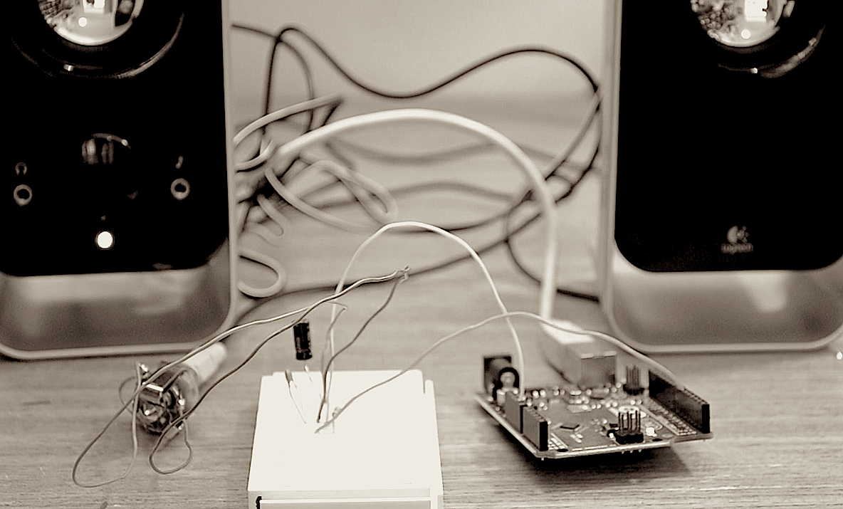

I followed a tutorial on using the Arduino for making sound.
the github link: GitHub - dzlonline/the_synth: A simple to use 4 polyphonic wavetable synthesizer library for Arduino.
Im noodling around and did some cool stuff with Arduino's before, tho i never had this error and googling it led me to C++ pages which are out of my league atm.
The error that occurs is as following:

Besides the errors, it compiles but there is no output what so ever. Is this then because of the shematic? i used an 10nF but didnt had a 10uF cap so used a 220uf and tried a 22uF aswell (those are the only ones around atm...) but no output. Or should i, using for instance the "any_hertz.ino", alter the library and change the ints?
I downloaded the library (GitHub - dzlonline/the_synth: A simple to use 4 polyphonic wavetable synthesizer library for Arduino.), unzipped, moved the 'the_synth' folder to my 'libraries' folder, re-started the IDE, opened File->Examples->the_synth->song and uploaded it to an Arduino UNO. Music plays (faintly) on a small speaker connected between Pin 11 and GND.
I ignored the 'narrowing conversion' warning messages but I did change the 'note<1000' to 'note<384' so it would not run off the end of the note or duration arrays. There was a compiler warning for that, too.
Edit: You can change 'melody' and 'noteDuration' tables from 'int' to 'byte' to reduce memory usage from 89% to 50%.
Edit 2: Changing the first element of tables.h:SawTable[] from 128 to 127 got rid of one of the warnings. Changing Env0[], Env1[], Env2[], and Env3[] from 'char' to 'unsigned char' got rid of the rest. Music still plays. Note that there are frequency tables at the top of table.h for 20 MHz and 16 MHz systems. For the UNO, comment out the 20 MHz tables and uncomment the 16 MHz tables. The music playes either way but the pitches will be off if you use the wrong table.
