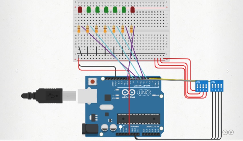

It is better if you post your fritzy into your post.
OPs Fritzy....
Tom... :slight_smile:
I am sorry but Fritzy diagrams do not show the needed information, there are no label on any switches or LEDs to say what they reperesent, the wiring crosses over so connections to the UNO cannot be identified.
Welcome to the forum.
http://forum.arduino.cc/index.php/topic,148850.0.html then look down to item #7 about how to post your code.
Can you please post a picture of a hand drawn circuit in jpg, png?
Your pen will be able to label and identify components.
Got it. Okay the program starts corectly, but when i turn the level switch off is the valve still open for idk another 19 seconds, then the heater turns on, but the washing cycle stops until the heater switch is in the position, that the temperature is enough hot and then the washing cycle continues. Tom help.
You are using two switches on each input so you can apply 5V and 0V to the arduino input.
A safer way is to switch the input with one switch and pull the input high or low when the switch is open with a 10K resistor.

List of inputs:
• start button = 1
• door switch = 2
• level switch = 3
• heater switch = 9
List of outputs:
• valve = 8
• heater = 10
• pump = 11
• washing left = 4
• washing right = 5
• squezze/wring = 6
• operation = 7
Estimate times:
• T1===2 seconds
• T2===5 seconds
• T3===7 seconds
• T4===28 seconds
• T5===10 seconds
Everything is like in the timing diagram you send Tom.
Interesting challenge. Lots of programs, all of different pieces of the cycle. I'm really wondering how you can easily program that in code, all the while keeping it flexible.
There's a quote complex finite state machine in here: a lot of states it cycles through. Each state being a part of the wash cycle, and each state having a separate duration after which the machine advances to the next state (in part also based on the sensor input such as the temperature for the heating stage). Within the states you may have different states, e.g. a "washing" state that moves the drum back and forth at intervals.
You want to keep those things as flexible as possible, preferably set by a bunch of #define or similar statements, or as an array, at the start of the program. This allows you to make easy changes to the washing cycle later.
It's a job made for cooperative tasks, some could use state machines.
4 inputs can drive 7 outputs, but if you code it in one logic knot it will be a bear to debug and a whale to change much at all.
The Start button cannot be pin1, that and pin0 are programming pins.
When washing left and washing right pins are both LOW, I assume the motor will stop?
You also need to note that
  • when the door switch is ON it gnds the input.
  • the start button is pressed it gnds the input.
  • the water level switch is FULL it gnds the input.
  • the heater thermostat switch is indicating low temp the input is HIGH.
