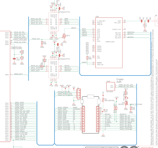

I try to run a watchdog timer together with the I2S bus.
Seperate they work fine, toghter they don't.
The I2S data is wired from the modems I2S_RXD to the cpu PA07.
The I2S clock is wired from to I2S_CLK to PA10.
The I2S word select is wired to PA11.
I'm reading the I2S bus with 16 kHz in 32 bit.
Everything works fine until i attach a watchdog timer (with every lib i can find) on the cpu's internal watchdog timer:
From my perspective i see no reason for troubles but it is just not reading the bus:
 while (vcs.getvoiceCallStatus() == TALKING)
      I2S.read();
I think it's a hardware issue within the SAMD21.
Can a hardware guru or someone else enlighten me?
Thank you in advance

Where do you reset (feed/kick) the dog?
Sorry, i did a cmd-z recovery of my sketch and pasted it too early in this forum. There was a reset.
sodaq_wdt_reset();
The topic is that when the SAMD21 watchdog timer is set, the I2S is not readable anymore.
With every watchdog lib i tried.
Why? Is there a way to make both things happen?
And do you reset the WDT properly?
If you don't reset it here and someone is taking too long the WDT will fire.
Yes, i did, trust me on this. I had the same issue with the wdt_zero lib and pushed a issue on github some time ago:
Since then there's no answer to this issue #9.
Now i'm facing the same problem again that's why i opened this topic.
Thank you for your effort!
For those who follow or will find this topic in the future:
This solves the problem. I don't know why aentinger added this to the merge and then removed it again. I will ask on github.
