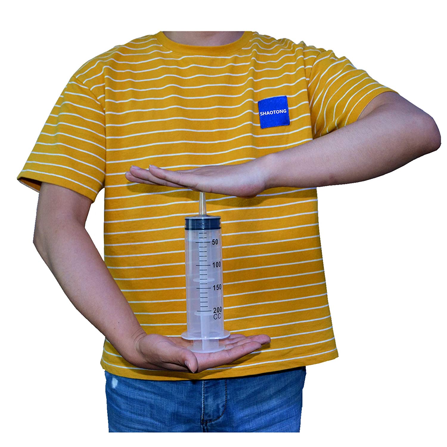

You could get a 200ml syringe and operated it with a geared motor or a stepping motor that is geared down.
OR a 300ml syringe:
OR a 500ml syringe:
