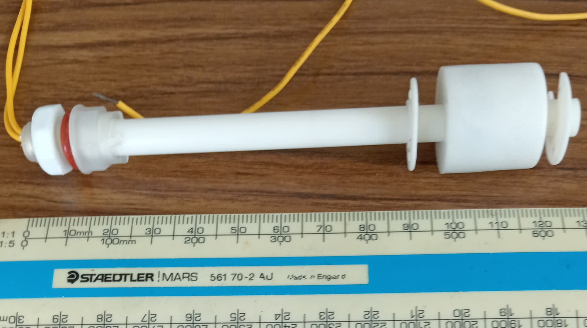

![IMG_20241203_113503](https://europe1.discourse-cdn.com/arduino/original/4X/9/1/e/91ef7374ff091847e1acdfb5a82745f13d4d829d.jpeg)
A proper float switch like this costs about a dollar.
