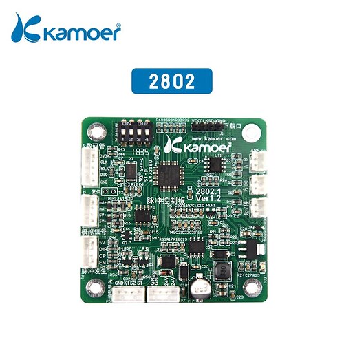

The pump has a stepper motor.
http://kamoer.com/Products/showproduct.php?id=242&lang=en
Indeed, a relay won't work for that pump. You will need the correct driver.
