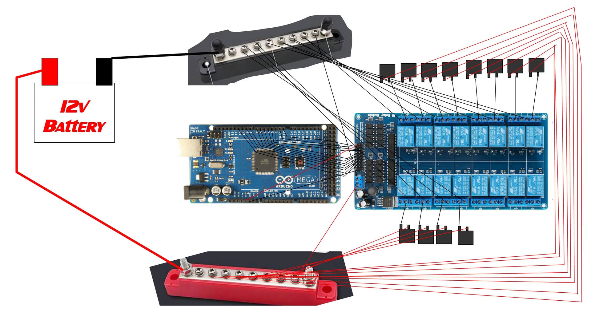

I did make a direct connection from the battery to the solenoids, because they do have a hig peak of a milisecond when turning on it will take to much ampere. It is via a relais on the breadboard. so it receives a signal from the solenoid, but the power from the accu.
Burning wires are replacebale and if you are lucky it gives a nice sound effect :wink:
See reply by @alto777.
The Mega does not have 18 analogue pins, only 16 (A0..A15). But you can use these as general purpose digital IO pins (input or output)
Please draw a schematic/wiring diagram of your setup. Every single wire (including power and GND)

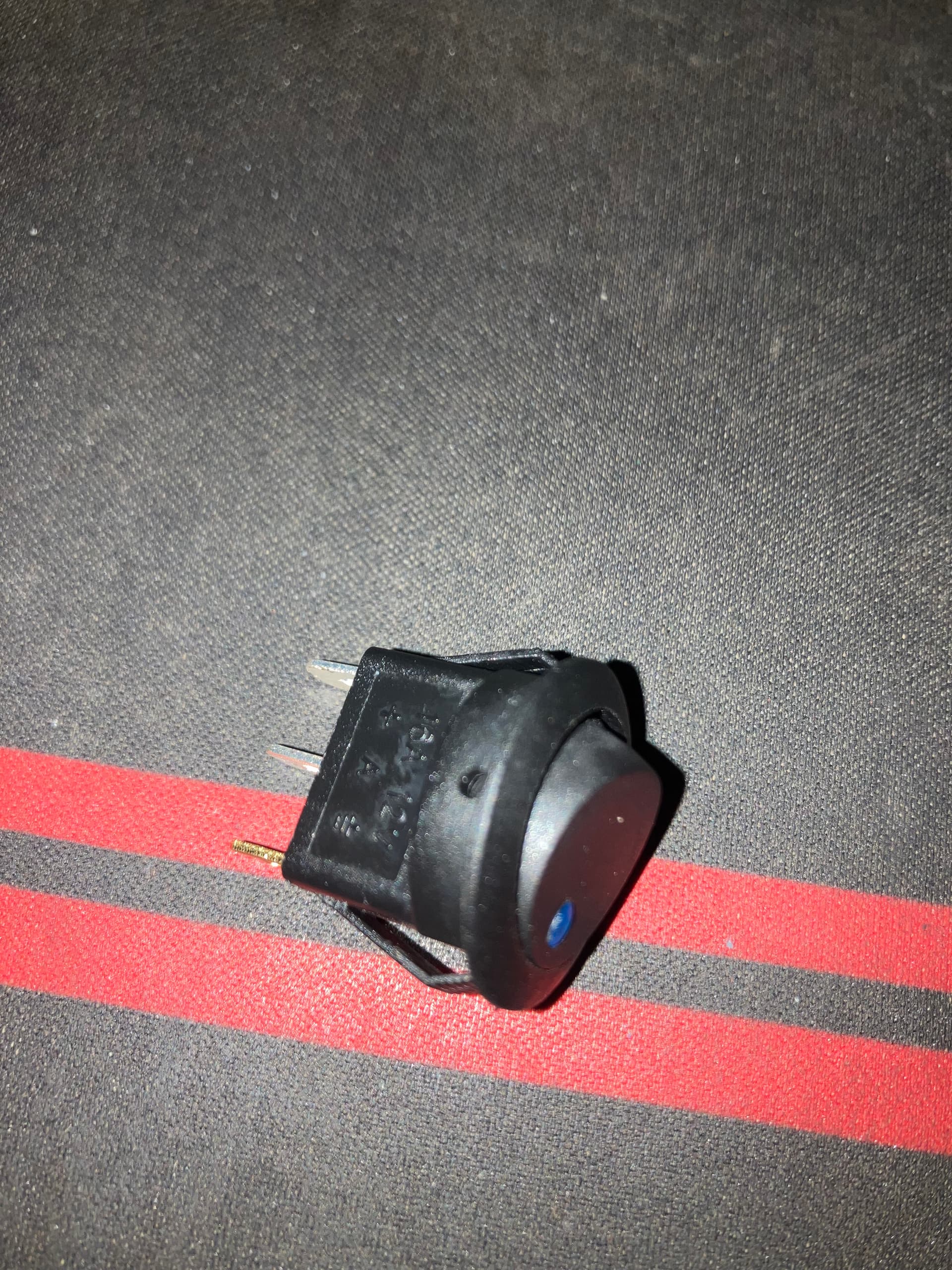

So to recap. I have a flip switch button, please code that into the script. When its off/flipped down and the arduino is still on, it plays the random code for the first 12 solenoids/pins. When its on/flipped up it plays the script for the show. Is that something you can tweak for me? Thanks.
So you were not using USB with this setup to power the Mega? If so, the Mega is powered from the relay shield. And you will need the GND between the shield and the Mega.
Or did I misunderstand?
Based on the schematic you seem to be using pins 0 and 1; note that use of those pins can interfere with uploads and serial receive/print will have side effects on your solenoids.

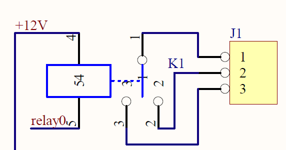

Do you have a link to (preferably datasheet) of the relay shield?
Yeah i didnt connect the usb. I will connect the power when i continue testing today maybe. And should i start at pins 2 and go upward to 19?
Not sure what you mean relay shield but this is the link on amazon where i got it.
Quick glance at your code shows that a sprinkler is on if you make the pin HIGH.
You can do some testing to determine the cause of the 5 seconds that the sprinklers turn on.
Keep the schematic as is but disconnect one of the wires at the Mega side (e.g. pin 12) and connect it to GND; if the problem for that specific sprinkler disappears (it does not switch on at startup) I suggest that you use pull-down resisters to get rid of the problem.
So you actually want me to connect my relay pin to the mega ground? Welp lets see how that goes. But to be honest the arduino switches the relays lights for 5 seconds anyways, i heard that thats how long it takes for the arduino to set up at start up. But i will try the ground thing and maybe test with a resistor to see if that helps too. But for now can you code the other things please?
Or the GND on the relay board.
This is the schematic for the relay board for those that are interested
16 relay 2.pdf (55.1 KB)

While I was typing the above, you provided the link to the relay board. I did extract the schematic from the manual (posted in post #32) but did not have a close look.
As far as I understand it, you can power the Mega from the 5V from the relay board; as said, you will need the ground connection between the relay board and the Mega, else you don't have a closed circuit for it. Be aware that if you power the Mega from the 5V of the relay board, you should not connect the Mega to your PC; something might give in.
Next the schematic indicates that the relays are activated with a LOW signal; if you don't connect the inputs, the LEDs should be off. A non-connected input INx is the same as a connected input to a pin of the Mega while the Mega is in bootloader mode or if the Mega is running an empty sketch.
I think that your 5 second problem comes from the fact that you, by the looks of it, have wired your solenoids to the wrong terminal of the screw connector.
Each relay has three contacts, COMMON, NC and NO.
  • NC stands for normally connected; if the relay is not activated and the solenoid is connected to NC, you are actually activating the solenoid.
  • NO stand for normally open; if the relay is not activated the solenoid will not get power.
  • COMMON is the centre contact in the group of three.
If I'm right, you will need to move the GND of the battery to the screw terminal in each block of three that is currently not used.
You will also need to change (in the code)
// sprinkler will be on if pin is set HIGH
#define SPRINKLER_ON HIGH
to
// sprinkler will be on if pin is set LOW
#define SPRINKLER_ON LOW
Note
COMMON is usually connected to the the live wire (in your case that would be 12V) and not to GND.
The arduino will be on the whole time, the button is just to switch between the random sprinkler activation and the show. So when the button is off/flipped down it will just play the random sprinkler event and it will continuously keep choosing a random sprinkler every 3 minutes till i flip the switch up/on and that will play the show code and activate the sound card to play the .wav file for the show lets just call that file "SHOW.wav". Then when the show is over i just flip the switch down and itl go back to the random sprinkler code and of course the music should cut off too. And if i want to play the show again i can do that by flipping the switch up again. And sorry no their is no schematics on the sound card that i know of.
Ill just be using a basic flip switch for this.
So my wiring is wrong? why does it work then lol? In this picture which one is right? Left or right?
Yes and no. It is correct in the sense that it will work, it really doesn't matter.
It is wrong because it is unconventional. And if you have N relays, they all ought also to be wired identicammaly, just for sanity.
It's like using red wire for positive and black for negative.
@sterretje is aware of a convention I had not known, or used.

A suggestion for next drawing: use parallel lines for connecting wires.
Well i just need it to be wired in a way where the solenoids arent drawing current when they are not being activated by the code and draining the battery. Not sure what happened today but my battery got super hot, not sure if it was a bad battery but i will have to test again on saturday with a different one. None of my cables were hot so i think it might have just been the battery.
Got it.
This is from the schematic
I can not say what is what on your board; I'm used to relay boards where pin 2 on Jx is COMMON but looking at the schematic this board is different. But I would connect pin 1 in the schematic to the 12V.
If the board is powered but the input pins (that you connect to the Mega) are not connected, there will be a connection between either 1 and 2 or between 1 and 3; the pin that is now connected is the NC pin. The LED of all relays should be off.
If you have a multimeter, you can measure the resistance between the pins on e.g. J1; the board can be powered on while doing that.
Next you can connect one of the input pins to the GND on the relay board; the LED associated with that pin should turn on and the connection from pin 1 should switch. So if without an input pin connected the connection is between 1 and 2, the connection will change to 1 and 3. In which case you need to connect your solenoid to pin 3.
To prevent your 5 second problem when the Mega starts up, you need to connect the relay to the pin that is normally not connected (NO); in the above description pin 3.
In short, you need to connect the solenoid in such a way that of the relay board is not connected to the Mega, the solenoid is not activated and if you short an INx pin, the associated relay/solenoid is activated.
